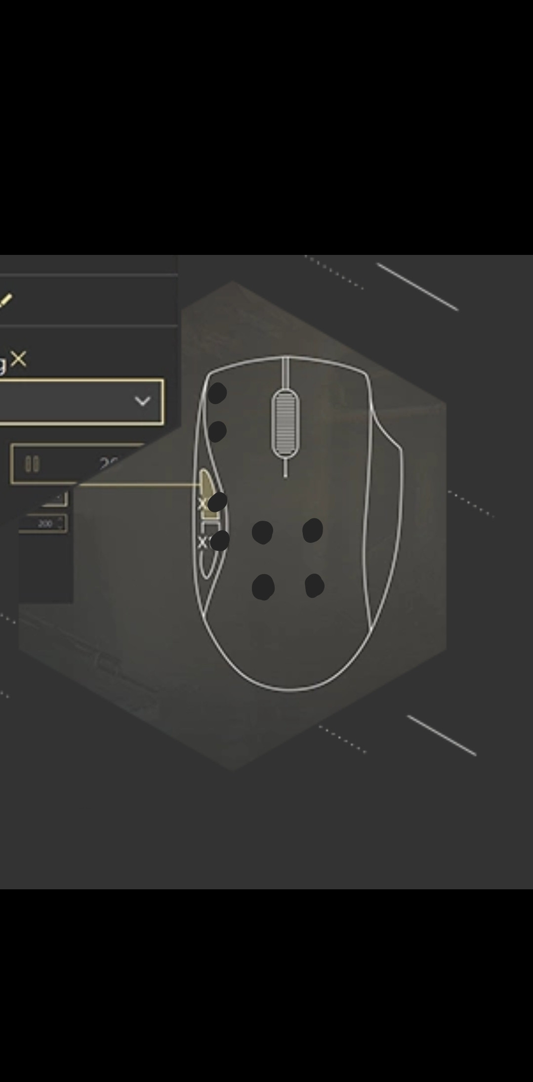

    1) The ability to add additional buttons to the reWASD is fantastic. However it's not overly aesthetically useful. When we 'add additional' button, is there anyway to create a circular interactable button which you can move around on the screen and place it in relation to where it is on the mouse?
    So for example, your current default mouse has the 2 buttons on top, the middle scroll wheel and 2 mouse buttons on the left hand side. If I add a new button, it'd be great to have a small circle pop up on the screen that i can drag to the appropriate location on the mouse. Just for future reference when i want to alter that button.
    Pretty interesting idea. There is no way we could associate the additional mouse buttons with your physical mouse. Each mouse reports up to 5 buttons only, and all those additional things are a part of the keyboard. Still, we could let users adjust the picture, but it is a big task, and so I won't promise you any fast updates.

      1) Yeah, to be fair, there are 8 additional buttons I've mapped already using your normal method. Each button has 1-2 functions on them. Works like a charm.
      Even something as simple as Black circles on the screen which we can drag into the appropriate place would be a huge benefit as I can immediately tell where my buttons are (see attached).
