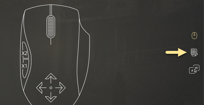

    Thanks. That seems to work!

    Oh, I see. In case of a combined device (usual case for laptops), you are to initialize it as a mouse and set all keyboard binds at [Additional Mouse buttons] list of [Mouse] sub-config:
