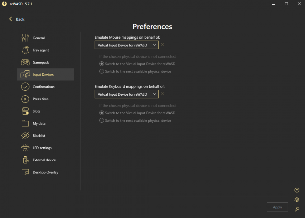

      Also, please try selecting your physical mouse and keyboard in reWASD preferences at the input devices tab, so our virtual keyboard and mouse are working on behalf of your physical mouse and keyboard:

              The input device settings determine on behalf of which device the actions should be completed. As you are mapping the keyboard buttons to the gamepad, our app, by default, creates an absolutely different, virtual keyboard for the remapping, and the game reads the input from the virtual device. Still, in your case, as you selected the Bluetooth Peripheral device, your gamepad will reproduce the mappings on behalf of your Apple keyboard. Mainly, this feature was created for Valorant game's issue fix, as the game read the input from the physical device only, but that does not matter for your case. You can feel free to select reWASD virtual keyboard and reWASD virtual mouse in the input device settings. It should work fine in apex.
