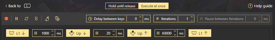

        So, once [LB] is pressed it should work as is, but when it is held for certain amount of time [D-Pad Up] must be tapped, right? If you have [Key Combo] and [Rapid Fire] features, this [Combo] with a [Turbo] flag enabled should do what you want:
        First pause is a time you have to hold [LB] for to trigger [D-Pad Up] tap. Second pause should be at least of 17ms value. A [Turbo] flag is there to stop the combo once you release the actual button. And the last pause is there to prevent repeat of the combo.
          Yes, i bought the whole version of the software. It seems to do exactly what i wanted, i need to test it further but i'm really happy with the result so far. Thanks a lot, it's really amazing!
          Interesting thought. I also tried to do the same combo on just LB, instead of long pressed LB. I also works, and seems snappier (which is logical). Couldn't i use your key combo with LB in turbo provided it only press LB for less than a sec anyway for any other cases?
            I'd need a more detailed description of at least one of "other cases" to give an example.
            For a button to be held for certain amount of time in a combo you'd have to add a pause between press and release nodes of the same button. Its value is the time in milliseconds. You can read about [Combo Editor] here.
              Alright, let's state the corollary then : Let's say that the only time i'd be pressing RB more than 1 sec would be in that precise wanted case. In this case, using your key combo on RB single press rather than long press is a strict improvement in terms of reactivity, isn't it? And in any other situation (<1sec pressure), RB would virtually behave like it was the vanilla untouched input. It seems like it to me for now, but i'm not 100% sure.
                Yes, that combo is meant for [Single Press] activator. It does exactly what you say. [D-Pad Up] tap will happen only when you hold [LB] for at least 1 second. You can change this time by changing first pause node value.
                  Ooh, but in your image, you were in the long press remapping (if you look at the indications above), and didn't specify where either, so I thought you wanted me to put the keys in long press.That's why i got confused and experimented the same key combo in single press also. Then all works fine. Very smooth until now. Thank you!
