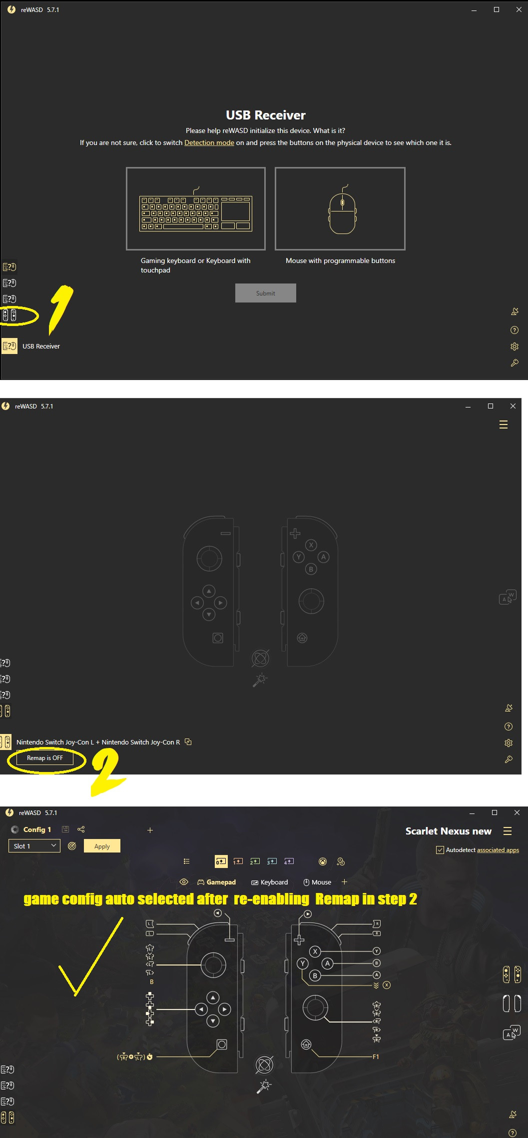

    Hello, I've been using reWASD with PS4 controller (bluetooth) to play games perfectly. When the controller turns off and I reconnect it, reWASD will automatically re-enable remap to the last profile/config I was using ( a feature I love).
    I've since tried using my Nintendo Joycon (bluetooth), but reWASD will not automatically remap.
    In order to play with Joycons, every time I reconnect the Joycons I have to:
    1. re-open reWASD
    2. select the "Remap button"
    3. Click image for larger version
Name:	Nintendo Joycons won't reconnect to Rewasd automatically.jpg
    I've tried
    • creating a fresh new config specifically for using the joycons
    • enabling the auto association w/ my game
    • restarting computer
    I never had to do this using the PS4 controller. Is there a fix or solution for this? I'm just trying to avoid steps 1. and 2. in images above everytime I use Joycons.
    Best regards

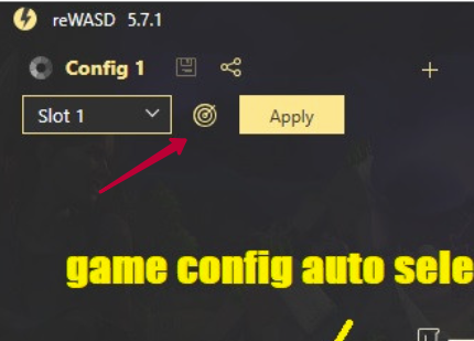

    There is one thing that seems to be wrong on your screenshots, here it is:
    This "Radar" icon should be turned on, and then you will see that "Config 1 will be applied to Slot 1", and with this setup, Autodetect should work properly. Please check it for me.

      That did the trick! Thanks a lot. You rock
