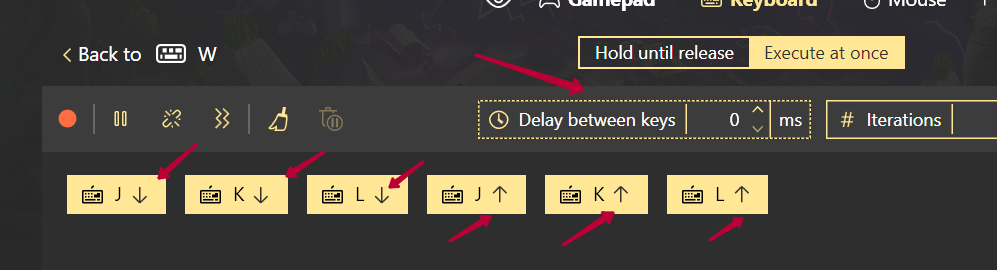

    Hey there! Which mode have you tried in the Combo Editor? I think, in your case, you will need Hold until release, and it will let you hold three buttons at once when you press a single one.
    Still, Execute at once may also work, but you definitely need to re-arrange the keys (so the presses (arrow down) come first and the releases (arrow up) come after and set Delay between keys to zero:
    Click image for larger version  Name:	c558ea02df.png Views:	0 Size:	86.1 KB ID:	226546
    Please try one or both tips to see how it works for you.
      Thank you very much for the quick help! Setting the delay between keys to 0 fixed it.
