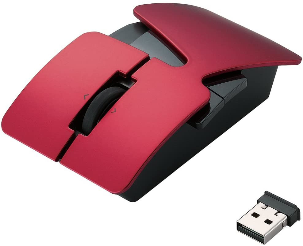

    I ran into a problem, my mouse "Elecom Nendo Design Kasane Manta Mouse" has essentially 2 more buttons, namely the scroll wheel can be pressed left and right ,but reWASD does not see them, how to solve this problem? Thanks for developers

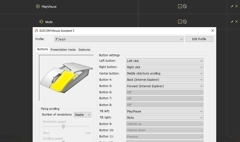

      Thanks, but I do this, but it's not working, what am I doing wrong? Or maybe soft of my mouse is not perfect? Click image for larger version

        Can't say from this screenshot alone. Does the [Tilt left] and [Tilt right] work as [Play/Pause] and [Mute] without reWASD?
        Can you try to enable [Detection mode] and do the tilts? What device icon is flashing when you do?

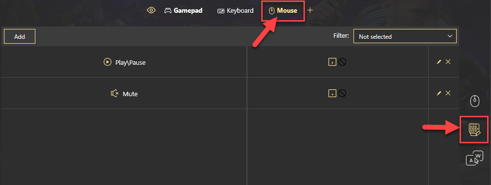

        If that device is your mouse, make sure it is initialized as mouse in reWASD (has a mouse icon, if not - right-click on its name and select [Re-Initialize]), and that you set mappings in [Additional mouse buttons] list of a [Mouse] sub-config, like this:
        If it's an another device, group it up with the mouse, initialize it as keyboard and set these mapping in [Keyboard] sub-config.

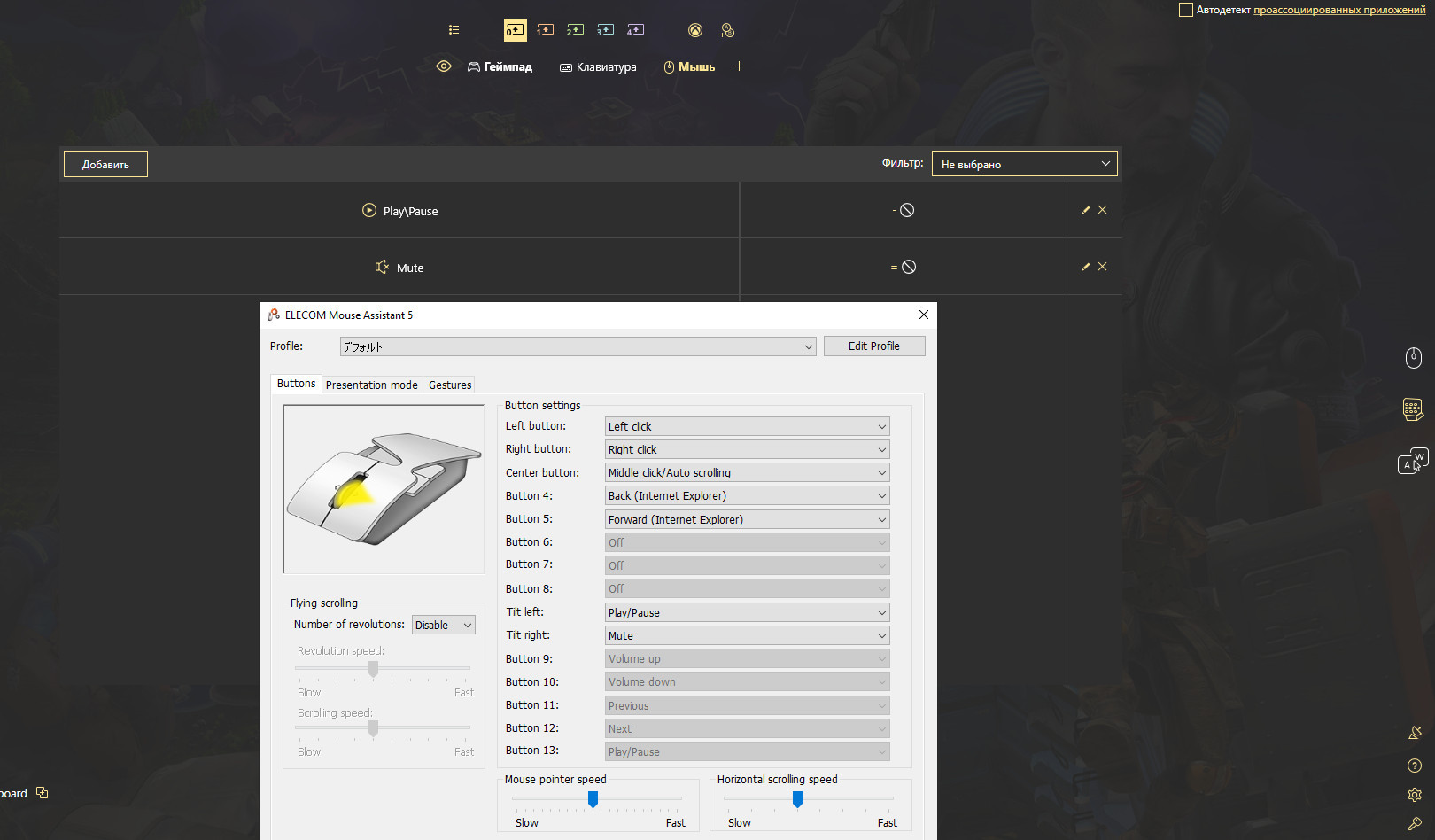

          Yes without reWASD "play and mute" working fine.
          Mous detect fine with all buttons, instead "tilt left\right" .

            It seems that reWASD is for some reason unable to catch [Play/Pause] and [Mute] inputs.
            Is it possible to set different keys/actions for the tilts? Ones that reWASD is able to catch?
