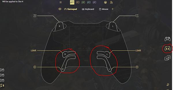

          Did you remap paddles to [A] and [B] buttons as usual or via [Gamepad mapping]? Please use [Gamepad mapping], as this doesn't require a creation of a virtual controller, which might be a reason of your issue.

            I did have A and B as usual via the reWASD mapping section, but I also have LShift mapped via this way as you cannot select LShift using Gamepad mapping.

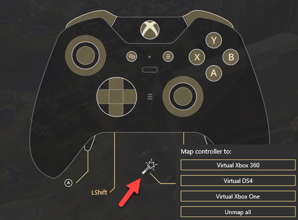

              Remap paddles to [A] and [B] mappings via [Gamepad mapping]. Click on [Magic Wand] in the middle and disable whatever is enabled if possible. If this won't help, send a screenshot of reWASD app with [Gamepad] sub-config selected and face of the controller visible. Or send the config file you're using. You can find the file by right-clicking its name and selecting [Open file location].

                  This is the [Magic Wand]:

                  It seems your config is already set up not to require creation of virtual controller, so it all should be good now.
                    Seems to be working fine!!
