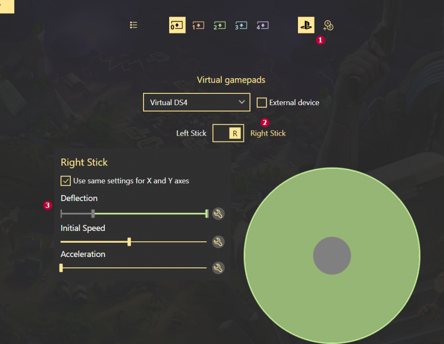

        Please try the following:
        1. Check the in-game settings. Pay attention to the stick settings for the camera. You should minimize the deadzone there + it is better to tune the sensitivity a bit, increase it.
        2. Do not set a big deadzone in reWASD. Start from the default one and make it a bit bigger or smaller if you need.
        If there are no deadzone settings in the game, you may need to make the gray zone for the Deflection bigger. Please follow 1, 2, 3 steps to tune the correct stick.
        3. It is important to understand that stick works in a different way. So, if you need to turn faster, you need to move your mouse longer, not faster. Also, you can try this workaround with zones described in the video.

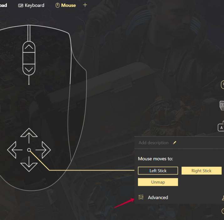

        4. Noise Filter, Sensitivity and Smoothing option that you could find in Advanced mouse settings here:
        Depend on a mouse you have. It is better to tune them one by one and check the results in the game — it is pretty hard to define the best values without trying
