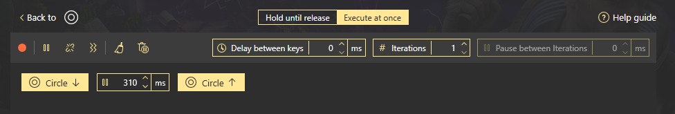

          Gettings! Back with some news: managed to install Warzone, and tested your config. I changed Circle Turbo on Long Press activator to this combo (since you don't need the Circle pressed all along while you Prone, as far as I can tell from the game):
          Click image for larger version  Name:	1.png Views:	0 Size:	54.5 KB ID:	226777
          I tried different pauses, but 310ms worked flawlessly. 300 was too little. Might as well try 301ms
          Then I fiddled with the Press time settings too:
          • 80ms for Double Press time felt fine
          • 150ms for Long Press made Prone snappier, which was also not bad
          As long as you feel comfortable knowing that you need to click Circle super-quickly to execute that combo you have on Single press, those numbers may work for you. But the thing is, you'd need to set them up to your preference, Try to lower them both from 100 and 200 by 10ms, Apply changes, and try in-game. See what works better for you, I don't think there's a 'correct' way to choose 'proper' numbers.

              Ok tried your config, worked like a charm, thanks alot bro.
