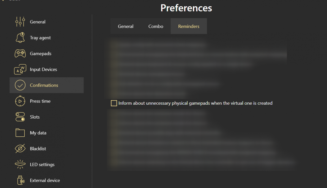

                  The easiest workaround here is the following:
                  Go to Preferences -> Confirmations -> Reminders and switch this option off:
                  Click image for larger version  Name:	4db8be10a9.png Views:	0 Size:	314.7 KB ID:	226829
                  Then, you won't see this message anymore.
