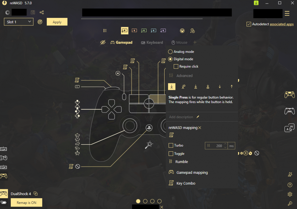

It works on bluetooth now BUT when I connected the USB cable, it's not working (the same way it did before). Please check the image. When I pressed a button, the app seemed to recognize it. But nothing worked in game.
So currently I need to choose between USB and bluetooth, and reset every time I need to change to the other connecting method. If you have a way out of this, please advise.
- Flag
Unfortunately, this problem cannot be completely resolved yet, but it will be fixed in Update 5.8. This version will be released within a week.
