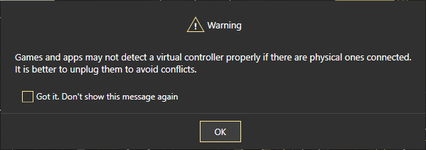

    Then I want to use my DS3 controllers, When Setting the re-mapping I have the followed message:

    The fact is I have completely disconnect the GC Adapter and the message is displayed at each time I make some modification on my controllers …

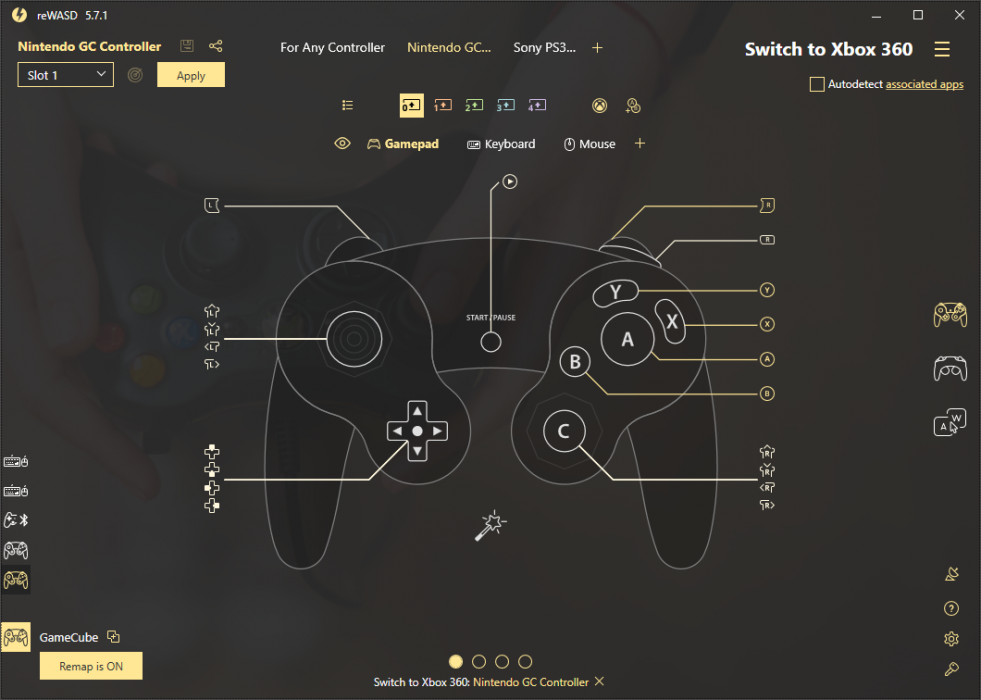

      Here are the reWASD window with the config I'm using:
      - GC Controller 1&2 (same remap & Slot) :
      DS3 Controller :
      Regarding assigned Slots, my understanding was1 controller = 1 slot. (With DS3 controller the Slot 1 blink the 1 Led and so on) but It seems to work with all controllers in the same slots, is there something I need to know about using Slot correctly ?

        The order of the gamepads in the system is determined by the system itself, not by reWASD. Also, Slots in reWASD do not belong to the players in the game, and only serve to switch the config.
        The warning in the program window is just an introductory notice. Check the box so that it doesn't appear again.
