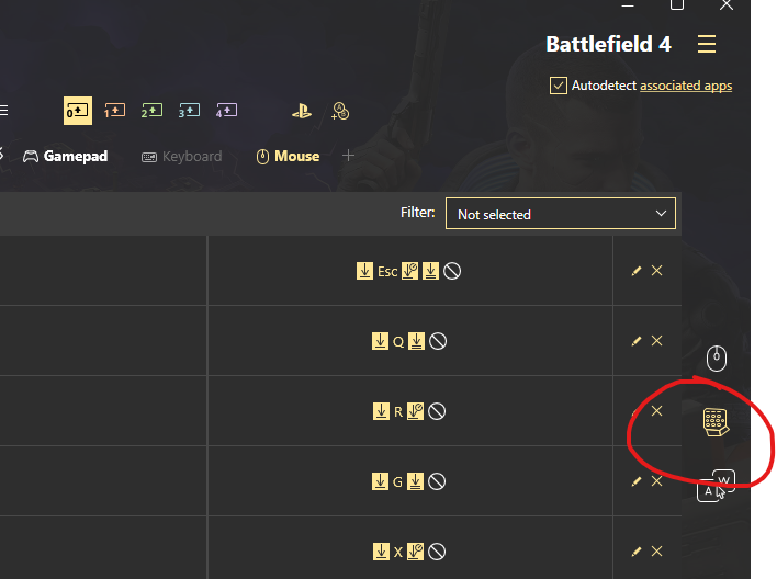

    Version 5.8.0 messed up something with my mouse (additional mouse buttons) assignments.
    I have a PS3 Nav + Mouse that have been working flawlessly for months. Tonight, just after 5.8.0 install I started noticing that (randomly) mouse buttons that were previously working 100% of the time were now a hit or miss. Particularly the ones assigned in the additional mouse buttons section below.
    Thinking I got a defective mouse, I tried updating to 5.8.0 in my other PC and experienced the exact same problem!!! 5.8.0 messed up something!!! please, tell me how to roll back. Thanks!

      In Rewasd (in the aditional mouse buttons section) I have mapped the ESC key as follows (you can see the image in my orginal post to check)
      Single Click: ESC
      Double Click: M
      Hold: Tab
      I noticed the following: If I only leave the ESC key mapped, responsiveness speed is increased. This is almost imperceptible, but I'm sensitive to small latency variations. ESC will work 100% of the time. It is when I add the Double Click and Hold assignments that you start noticing that now the ESC key have a 'very slight' delay in responsiveness and also 10-15% of the time it will NOT work, you will have to press the key again in order for it to work.

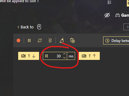

            You could try change the ordinary mapping to the combo (set 20-30 ms of Delay between keys) for this game, it should help.
              No problem, glad to know that it is solved now.
              Excellent tip! a Combo with 30ms pause between press/depress makes wonders. This should be an adjustable feature in the advanced section of rewasd. "Delay between press/depress"
                We are glad it works now!
                  We will think what is possible to do here. Thank you for the suggestion. Glad to know that it works now.
