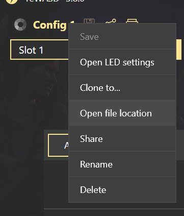

    2. It seems that you have applied some config that fails. Could you please send me the one you are using? The easiest way to find it is to choose Open file location option from the context menu of the config's name at the top left:

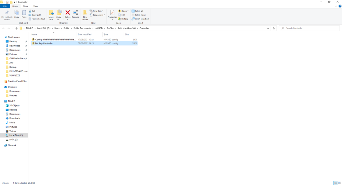

      I am using a Guitar Hero 2 Guitar plugged in via USB which Rewasd is recognising as an Xbox 360 controller. I've attached a picture of the file explorer.

        Could you please send me the file you have in the folder you have opened on your screenshot? I should check it from our side to be sure what happens there.
          Okay nice one thank you! I've attached both files that are in the screenshot

            In the Config 1 file, there are two mappings with F key: it is mapped to the X button and the stick click. If you apply this config and press stick click or X, you will get F key pressed.
            I assume, you should remove this config and do not use it at all.
            The second config turns the controller to the virtual Xbox 360 (however, this is the one you already have). What exactly do you want to do with reWASD? Then I could help you with creating a config that suits and doesn't execute the mappings you do not need.
