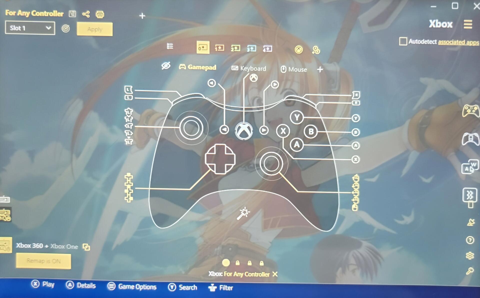

      Sure, here you go. Let me know if this has got everything you need or if you need anything else
        Probably the fact is that you have two different inputs at once. Try to use it simply as a controller without mouse mapping.

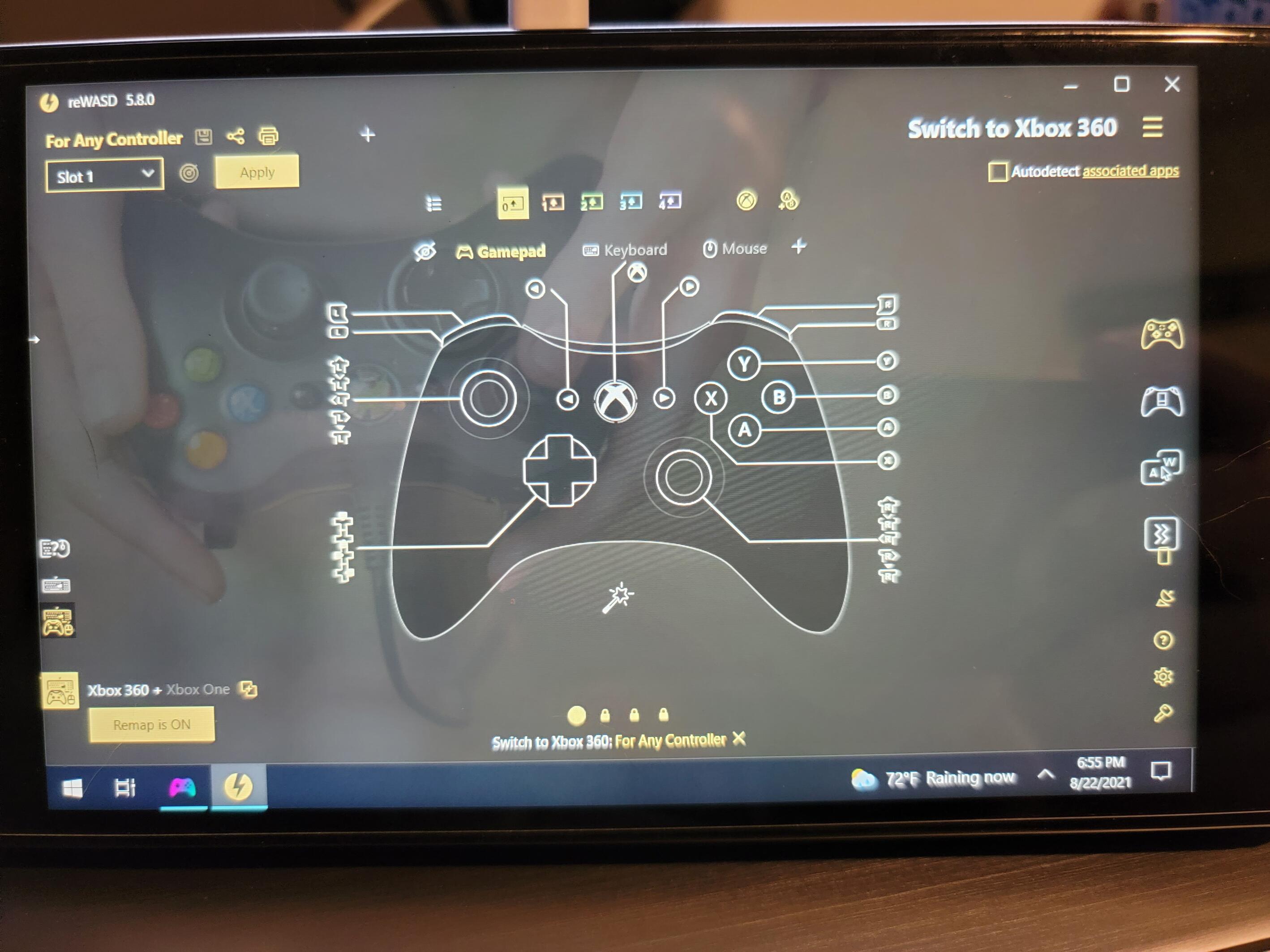

              Ok, what's happening is that I've set it to be the virtual X-Box360 controller in reWASD, but RetroArch does not pick it up when using the xinput driver, only the dinput driver. So it may be that reWASD is not behaving as it's supposed to be. I've been messing around with some other software that will actually show me the difference also (thinking it might be RetroArch rather than reWASD), and reWASD is definitely exposing itself as a dinput device rather than an xinput one.
              Ultimately I would prefer that reWASD be exposing the virtual controller as X-input. If possible I would also like to maintain using the right analog as a mouse control.
                reWASD creates a virtual Xbox 360 controller, which is the same as the physical one, which is detected as X-Input. Which other apps you are referring to? Have you tried to use Xbox One virtual controller in reWASD?

                  Both Xbox360 and Xbox One configs screenshotted above are showing up as dinput in every app I try (PPSSPP indicates an input differently depending on whether it's xinput or dinput so I'm using that to test also). When I take reWASD out of the equation, my local controller works as xinput. I think it might be a bug of some sort, not sure. I did create a new Xbox360 profile to use to test the virtual controller configured without any mouse inputs. I'm not seeing any config options in reWASD that might affect this.
