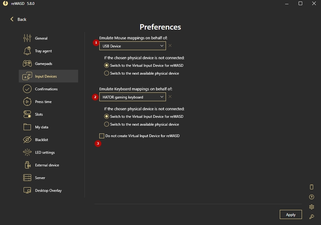

        Possible workaround: in reWASD you can make mappings work on behalf of your physical devices.
        To do this, you need to go to Preferences → Input Devices, and instead of [Virtual Input Device for reWASD] select your physical keyboard and mouse respectively.
        Alternatively, you can also try checking "Do not create Virtual Input Device for reWASD.Click image for larger version  Name:	aaf37d8d65.jpg Views:	0 Size:	102.4 KB ID:	227220
          I tried as you said, but unfortunately it didn't work . reWASD still does a virtual RMB click. I will keep trying and if I succeed, I will come back here to give feedback.
