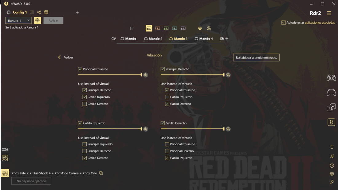

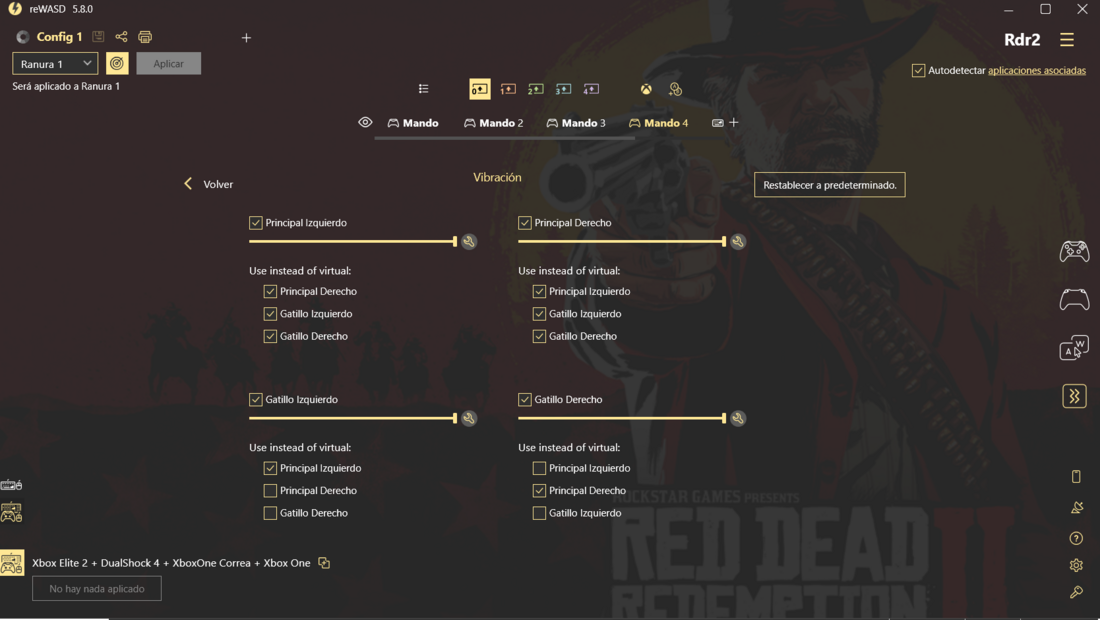

            Crashes still happening, the only way they don't crash is like in the pictures, I can use them like this, but if it's possible, if you can find the problem, I want them to rumble with all the motors all the way, the more they vibrate the better so I share a new set of logs so you can help me, thanks.
            Note: The problem is something with the section dedicated to trigger motors, that's all I could figure.
