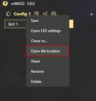

            If the movements are quite chaotic, as you describe, then it would be great if you could send us your config as file and record a short video of what happens in your game.
            To find your config file, just right-click on the config name in the left upper corner of reWASD and click on "Open file location".

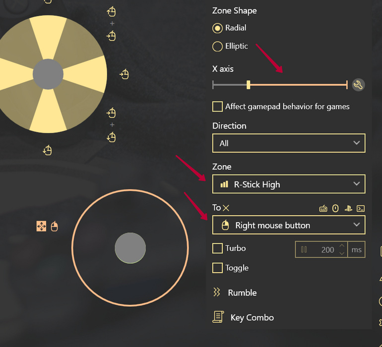

                The issue you are having is connected to the zone shapes. Right now, you have three separate mappings on all three zones, and so, when you deflect the stick you get continuous click-release each time you switch from one zone to another one. There should be a single zone, like I have here:
                I am attaching your config with this edition. Hope it will help.
