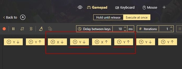

    So I've been recording my combos lately, I'm not able to recreate this combo I can do on my controller on ReWasd Reads
    x + y (delay{78}) x + y
    in the game it appears as
    y (x + y) y
    but the output I need is just
    (x + y)
    So how Would I go about getting the output I need
    Tell me if I am wrong, but you need each press to be a separate action. D-Pad down pressed, d-pad down released, then D-Pad down+D-Pad right pressed and released.
    And add the pauses between each action, so it will be easier for the game to recognize all the button presses.
      Not for the first part of the combo the first part does what it needs to do it's the end of the combo where x and y aren't seen as one press
        The simplified version of the combo
          At the key combo editor, simultaneous press is when both buttons have same arrows. Arrows mean whether it is press or release. Arrow Down - press. Arrow up - release. You need to drag with the mouse press of the second key (Y) and put it before release of the first (X).

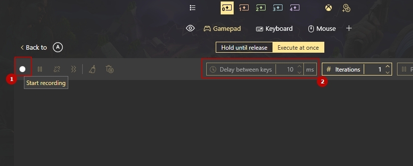

                Try to record the combo manually using the Recorder. Also remove the delay between keys before this.

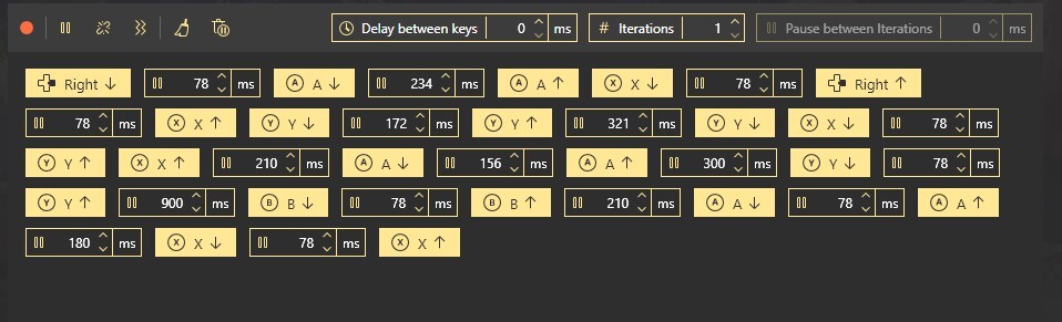

                  so i was able to get it done heres what it looks like complete i definently need delay or id have to go in and add 20ms of delay to each button
Name:	Ls combo.jpg

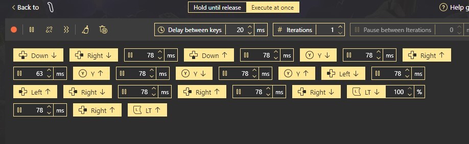

Name:	working combo.jpg
ID:	227370i also was able to get this one done before this but this is still incomplete im still fixing the delays and timings
