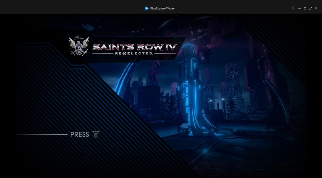

          I am talking about PSNow, not remote play. The game I'm playing requires the touchpad to be pressed down and on an xbox controller there is no way to do that without reWASD. This is what I see when I start up the game. I cant get past this screen.
            I have just checked the same game. As for it is pretty old one, it asks to click Start which is mapped to the Right part of the touchpad.

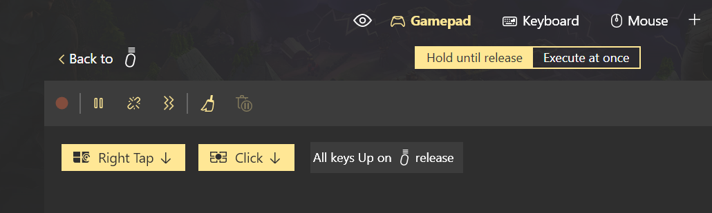

            You should create the following combo:
            and map it to the button you want.
            Also, please ensure that you start PS Now and the game after you turned Remap ON.
