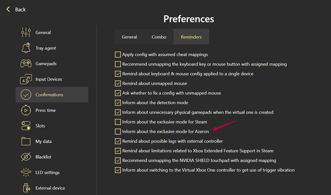

    In theory there shouldn't be any problems if hub works as an invisible relay. But if you can connect them to your PC directly, please try to.
    Try to disable initialization part by unchecking this option:
    Click image for larger version  Name:	769adde13c.png Views:	0 Size:	267.9 KB ID:	227498
    Once done, use the [Clear data] button at [General] tab and try to group them up again.
    If none of that helps, we'd like you to make a step by step video of what are you trying to do and what actually happens.
