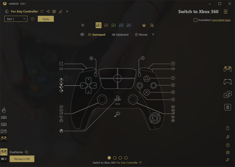

      The following screen shot (if I uploaded it correctly), is the default Xbox 360 remapping of my DualSense controller. Unless I am mistaken? Regardless, it is this config that does not seem to work with Star Citizen. Double checked, before posting this response... still does not work. However! As I mentioned, I am able to make a new config and that works. So you may consider this topic closed if you wish.

        And the problem is right there on the screenshot. Based on the icon I see after 4th [Shift], that config remaps to a virtual Xbox One, which, I assume based on answer #2, is not supported by Star Citizen. New configs have virtual Xbox 360 set by default, so that's the reason new one works.

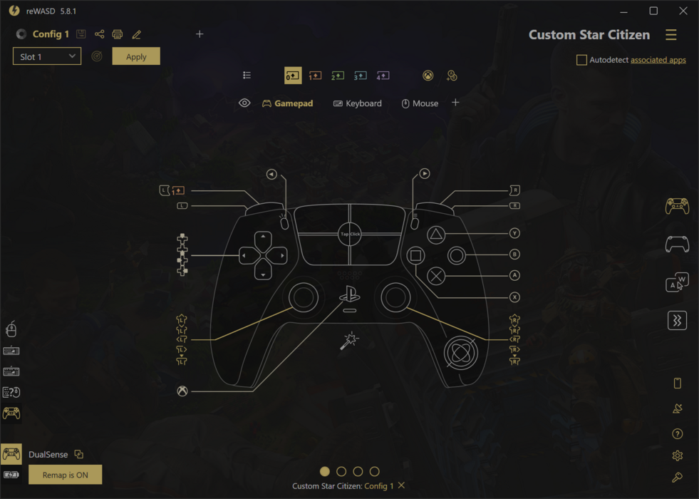

          I am sorry, but how did you know that, and where does it say Xbox One? Am I understanding you correctly that the difference is with the outlined circle around the 'X' signifies 360 (my screen shot of my working config below)? Vs the first screen shoot where it does not have an outline around said 'X'? Did this happen during a reWASD update? The default config produced by the "Magic Wand' I clicked months ago, produced a 360 config (given the name in my first screen shot), but a new update to reWASD made that config an Xbox ONE virtual device without naming it maybe?
Name:	reWASD 9_10_2021 6_29_07 PM.png

            Ah, I see now. Yes, I probably messed with that setting during my troubleshooting adventure.... toggling it now...
            HAHAHaaha yes, that worked. Setting it _back_ to 360 solves the issue. I wish I knew why I couldn't get it to work before (I recall it was set to 360). Obviously some other error on my part!
              Yes. The icon shows what virtual controller is selected for current config. You can change it in two ways: by selecting another controller at [Magic Wand] menu or by clicking the icon itself to open virtual controller settings, the choice will be available there..
