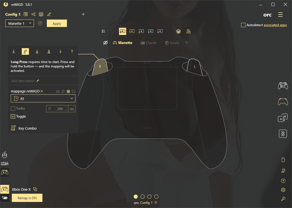

    Hi all,
    I am tring to change the press and hold of the RTrigger to fire automatically, bgut it does nothing in the game
    For testing i tested mapping RT to the A button and it change nothing.
    What i am doing wrong ? This Steam game is not supported ? Thanks !

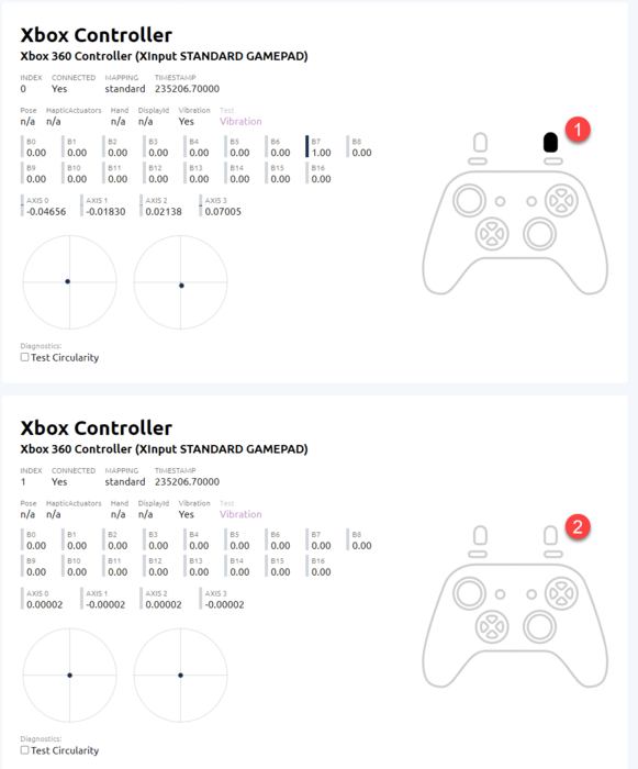

    Also check the work of this mapping on the gamepad tester. Does it work there?
      No tested yet on another game, but with gamepad tester :
      Toggle : do nothing
      Turbo :
      1 - stay blacked
      2 - blink as key press hold and release each 200 ms ( as in reWASD config )

        As per your screenshot, everything works as intended. As per your message mentioned as turbo 1,2:
        1. This is how toggle works
        2. This is how turbo works
        Both functions belong to the Rapid Fire feature. Please check this article for the details.
        For your information, toggle makes the button continuously pressed, similar to how caps lock works. In order for the mapping to be constantly pressed, you should press the button at once and press the button one more time to release the mapping.
        In your case, as you want to apply toggle to "Long press" activator, you have to press the button for some time for the activator to trigger.
        Press time for triggering the mapping can be adjusted in reWASD Preferences → Press Time → Long press time as I mentioned in the previous post of mine.

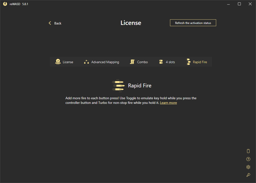

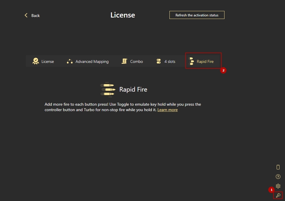

            Please send the config you are using. Your configs are stored here: C:\Users\Public\Documents\reWASD\Profiles.
            Also check if you have activated the Rapid Fire feature (button in the form of a key).

                  Hi, the rapidfire license seem ok.

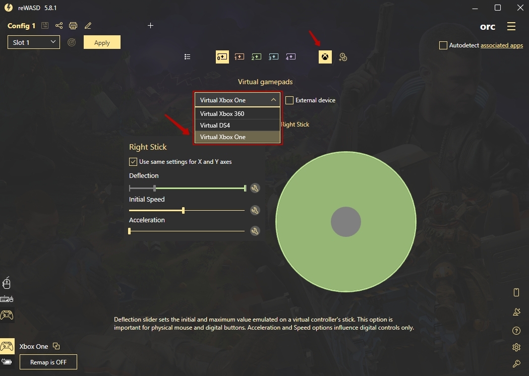

                    The first thing I can recommend is to change the type of virtual controller.
                    First you change the type of virtual controller, then apply the config and run the game.
                    If that doesn't help, maybe you should increase the turbo pause, because not all games can accept 1ms pause.
