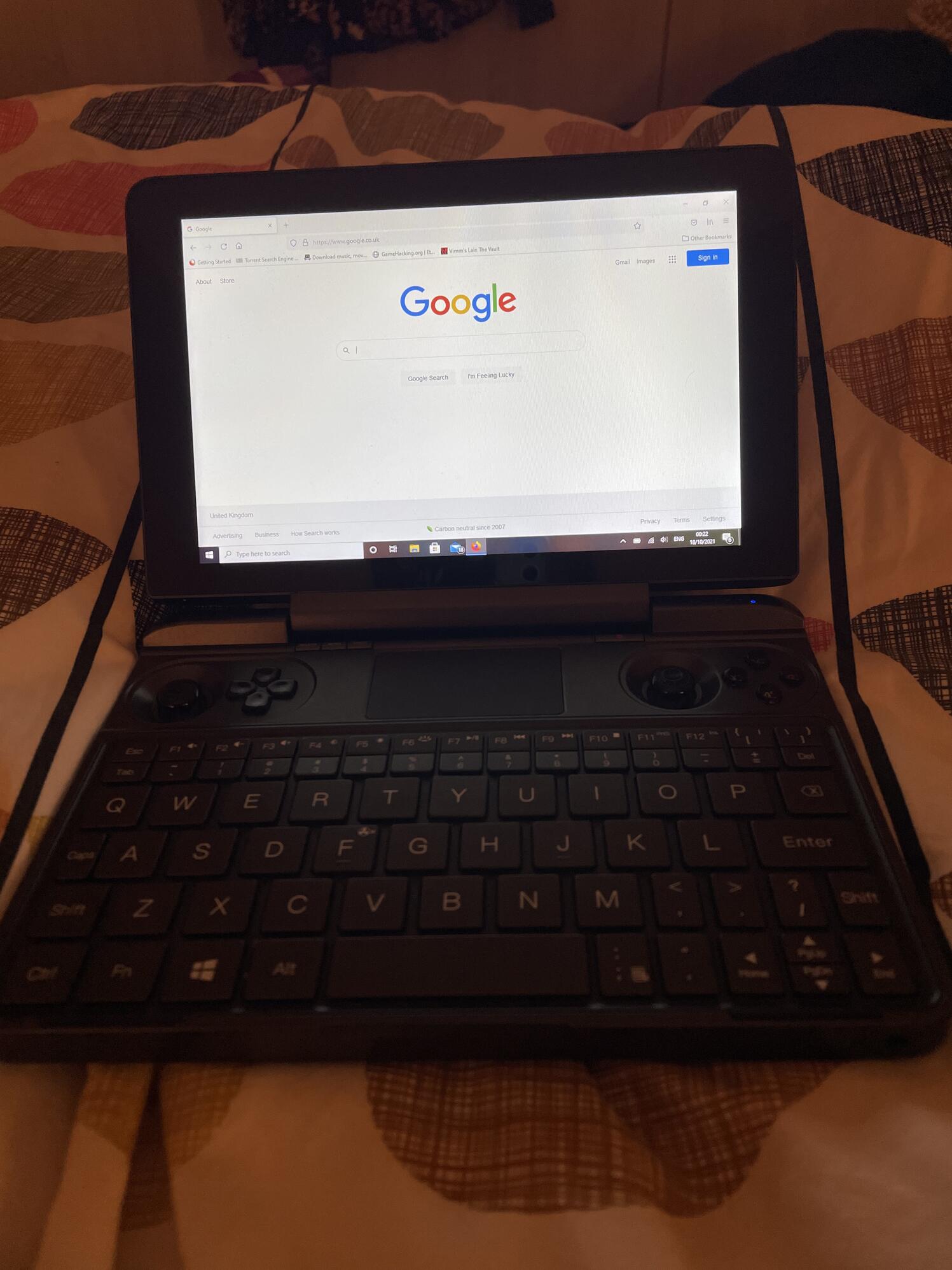

      This is the device I am using. It is called a Gpd. I want to emulate the PS4 touchpad on it. Is that possible?
        You can create mappings of virtual touchpad swipes and touchpad taps for any physical buttons on your devices.
        To do this, you need to use a virtual DualShock 4 when creating/editing the config.
        Earlier, I provided you with a link to an article about virtual touchpad emulation. Did you read it?
        If I understand correctly, your device has an integrated controller that is recognized in reWASD as an Xbox controller. So if you want to remap your physical touchpad, you can't because the physical Xbox controller doesn't have a touchpad.
