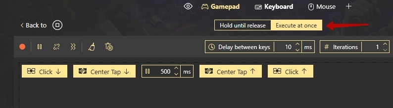

    Try using a combo in Execute at once mode and add a pause of about 500ms between pressing and releasing, as in the screenshot.

      I tried, but it didn't work. I managed to get working by using toggle, thought.

        Different games request touchpad interaction in different ways. But we're glad you were able to find a solution.
