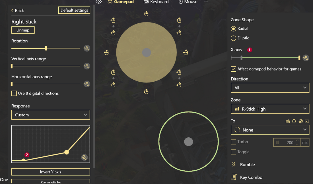

    I would suggest that you increase the deadzone a bit, it will help reduce the issues with small movements. You can do it here (1) or change the curve so the first point is placed on X axis (2):

      May I see that screenshot with the numbers? I tried changing it, but it messes everything up and returns my deadzone to 8000.
        I don't have any movement issues just the blur. I increased the dead zone and really nothing but reduce my small space movement. Where I placed the points is BASICALLY how a mouse reacts. There it'll do the smallest movements that people do holding down a spray or getting someone who leaned or ducked a little, the subtle movements that a mouse allows. My goal here was; A) having a natural reaction and NOT spin out of control B) the spin....omg the spin...So at that point, give or take, i can pull the joystick at the speed of my fingers and it reacts to my reaction, So A ok. Second part, the spin, i'm messing with the mouse pointer speed. But overall there's blur.
