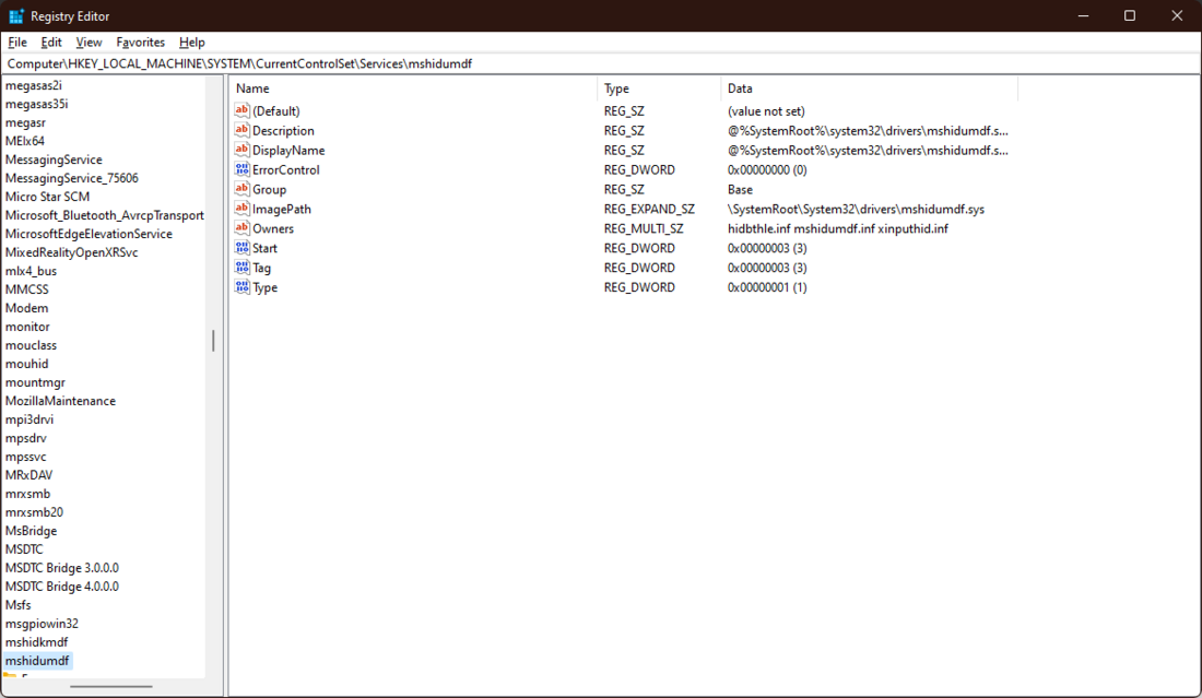

    1. Post #6 regarding making sure mshidumdf in Registry has its Start key set to 3.

    In addition to that, I also found out that Owners key in my Registry initially had oem28.inf, which appeared to have something to do with a particular OEM recommended app, KB9X Radio Switch Device. So I went ahead and uninstalled said app, and removed the reference from Owners key (uninstalling said program and rebooting PC did not appear to automatically remove it).

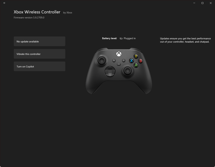

    3. Partially post #8 regarding checking the controller's firmware version. Should be up to date.
