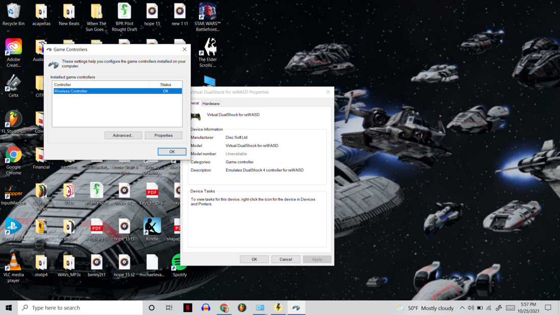

      Hi thanks for the quick response
      Here's a screenshot of the joy.cpl screen

        And I did get a response from the buttons on the gamepad tester yup

            I'm seeing now that the virtual DS4 is not connecting to my computer, but I'm not sure why. The wireless controller coming up under joy.cpl is the physical controller. When I change to DS4 and have my physical controller hidden under rewasd preferences, nothing shows up under joy.cpl. When I emulate the xbox controllers, those do show up under joy.cpl.
