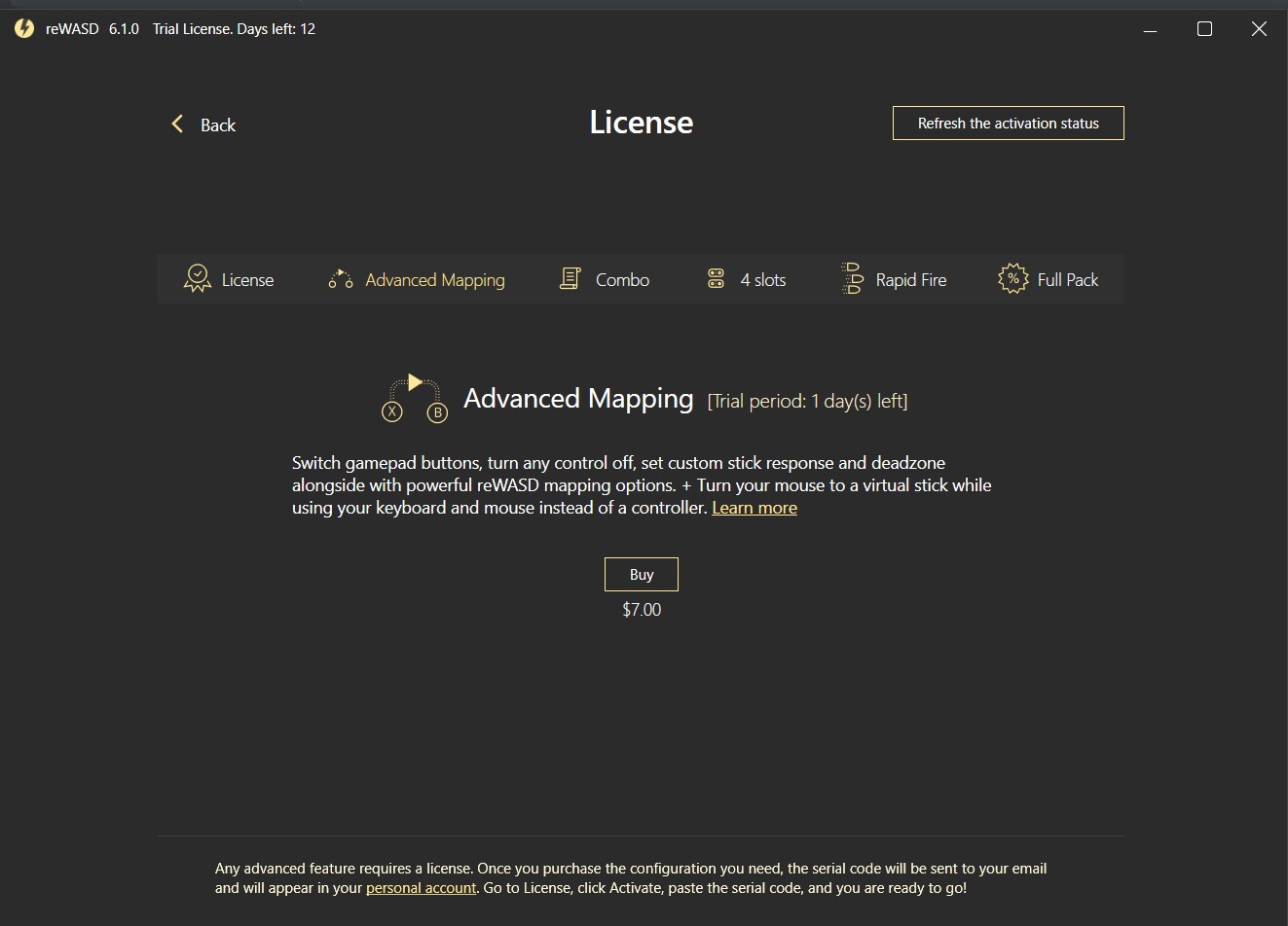

    Please check for the Advanced mapping feature to be enabled. You can enter the reWASD license tab (key icon in the bottom-right side of reWASD window). It is required in case you need your mouse to act on behalf of a virtual controller stick.

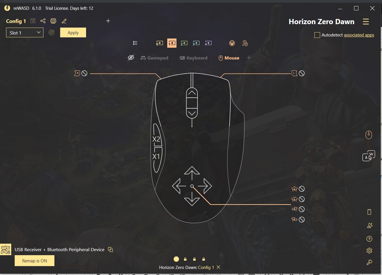

    If advanced mapping feature is active, please send us the screenshot of your config on a mouse tab and another one for the group of devices, so we can check if everything is set up correctly.

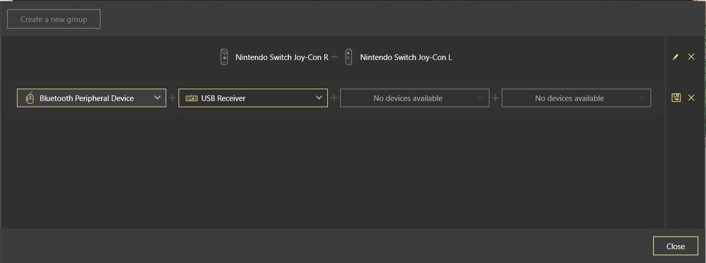

      Hi, Im evaluating the ReWASD and facing the same issue as the thread starter. The pointer is still active after the mapping is enabled. Im using Logitech MX Master 3. Keyboard mapping is fine though. Please see the following screenshots. Click image for larger version
ID:	230778Click image for larger version
        There is a chance that your devices have been initialized the other way around (mouse as keyboard and keyboard as mouse).
        Try clearing the data. Open → General → Clear data button.
        Confirm the action, after which the reWASD GUI will restart.
        Then use the device detection mode.
        After that, when you understand which device is the mouse and which is the keyboard, manually initialize these devices accordingly.
          Thank you! Problem solved. The keyboard and mouse are using the same receiver. I have since linked each device to each individual receiver for easy grouping.
