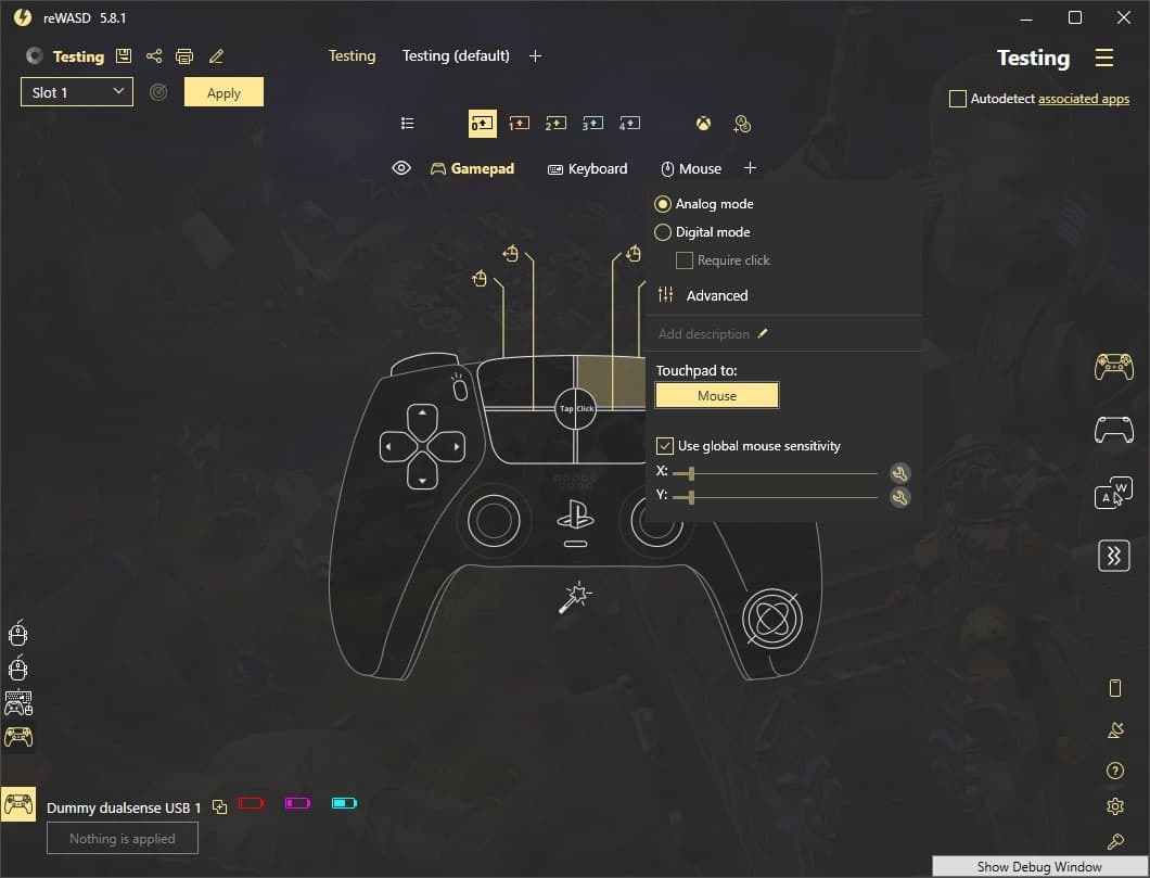

    I want to try to emulate a touchpad mouse stick (like the steam controller), using the right thumb for the whole range of motion. I think this is possible with Steam Input, not I can't find a way to do it in REWASD, so just checking if it's possible or not. Thanks.
    It is indeed possible to remap your touchpad as a mouse in reWASD, but it will be more like a laptop's touchpad.
    For that, please select your touchpad in reWASD, make sure to switch to the analog mode. Once done, you will see a possibility to map it to mouse.
      Sorry but you didn't answer my question. I know you can map the TouchPad to a mouse. But I want to know if you can remap half of the TouchPad to the mouse, like you can on steam input, as I didn't find a way to do that.
        I am sorry for understanding this not correctly, there is no way of doing so in reWASD, regretfully.

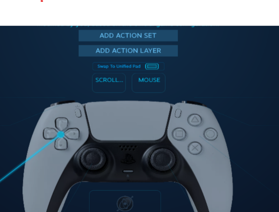

            It's called unified or split pad, you can see it in this video too: https://youtu.be/dvEj-MOGmT0?t=131
            Would be nice to have a similar thing in rewasd, to have 2 zones reachable with thumbs.
