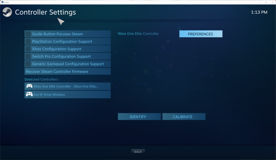

    Under steam, all controllers are unchecked.

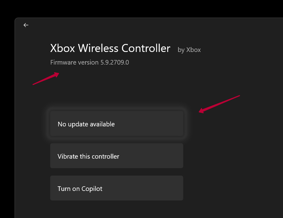

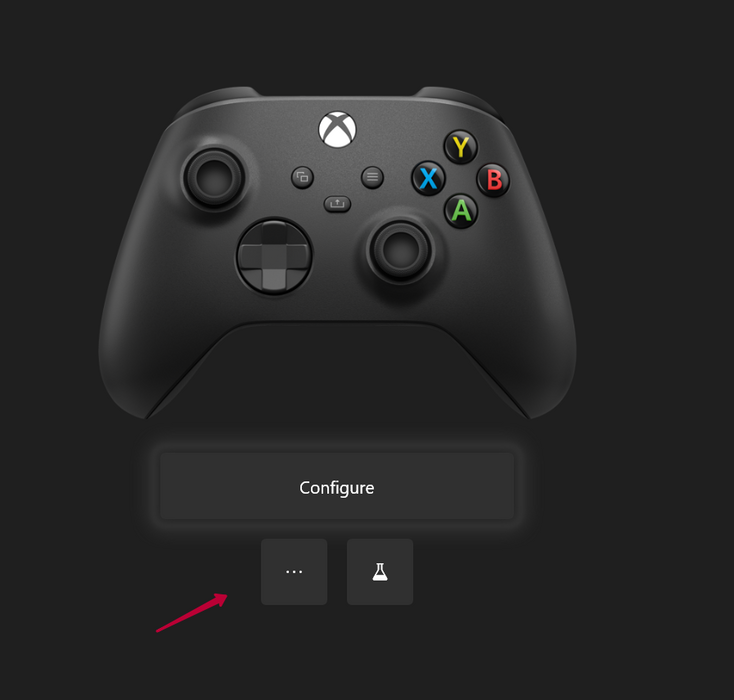

        Firmware version is not needed anymore, as you've got it to work. But if you are interested, it is available in Xbox Accessories app here:
        If a firmware update is available, and it is 5.11.3118, do not update! This is a beta firmware and we are unable to work with it properly just yet.
        We also do not recommend to update to any 5.11 version for now, as there is a lot of negative feedback around it.
          A conflict between Steam and reWASD is quite possible. Try disabling controller support in Steam.
