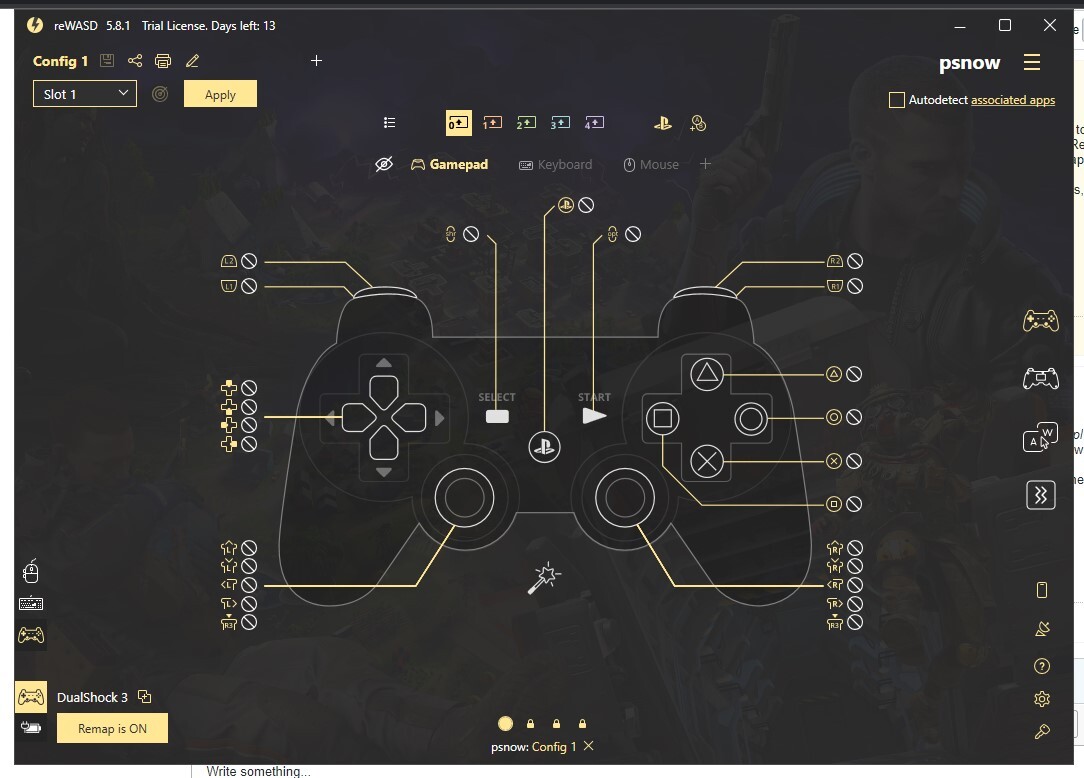

    Hello, I tried rewasd yesterday to use a ps3 controller as a ps4 controller on psnow, it worked like a charm. Then I decided to uninstall ScpToolkit as I tought it was redundant (I used it to use ps3 controller as x360 controller for old games), but now I'm unable to use the controller at all. Rewasd detect the controller (it detect when i click a control on the controller in the remap, and if i click on the ds3 icon it vibrates, and the overlay show the correct ramapped controls when clicked), but it's not detected at all by ps now, the controller icon is always grey.
    I tried to uninstall and reinstall both rewasd and psnow several times (and even ScpToolkit), other than the controller drivers, but I'm not able to make it work.
    Any idea? 😅

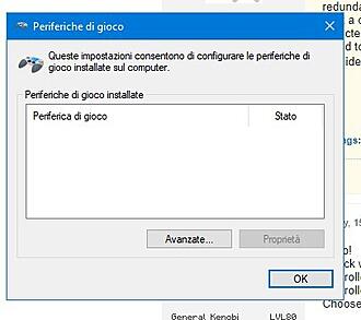

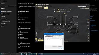

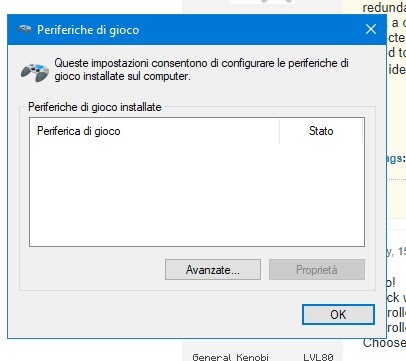

      inside joy.cpl no controller is detected (see attachment) while remap mode is on. I even tried with a third party x360 controller and while is not on remap mode windows and ps now detect it (and it appears inside joy.cpl), when I active remap mode (with th same configuration as the screenshot) neither windows nor ps now detect it.
      Physical gamepad inside preference is checked.

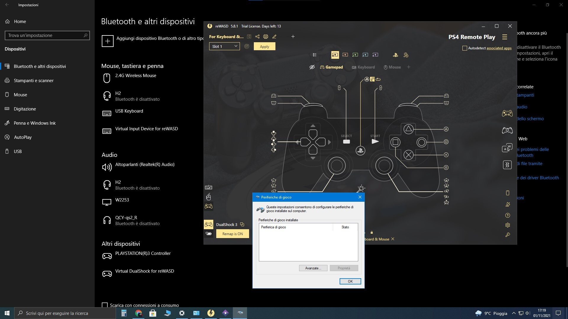

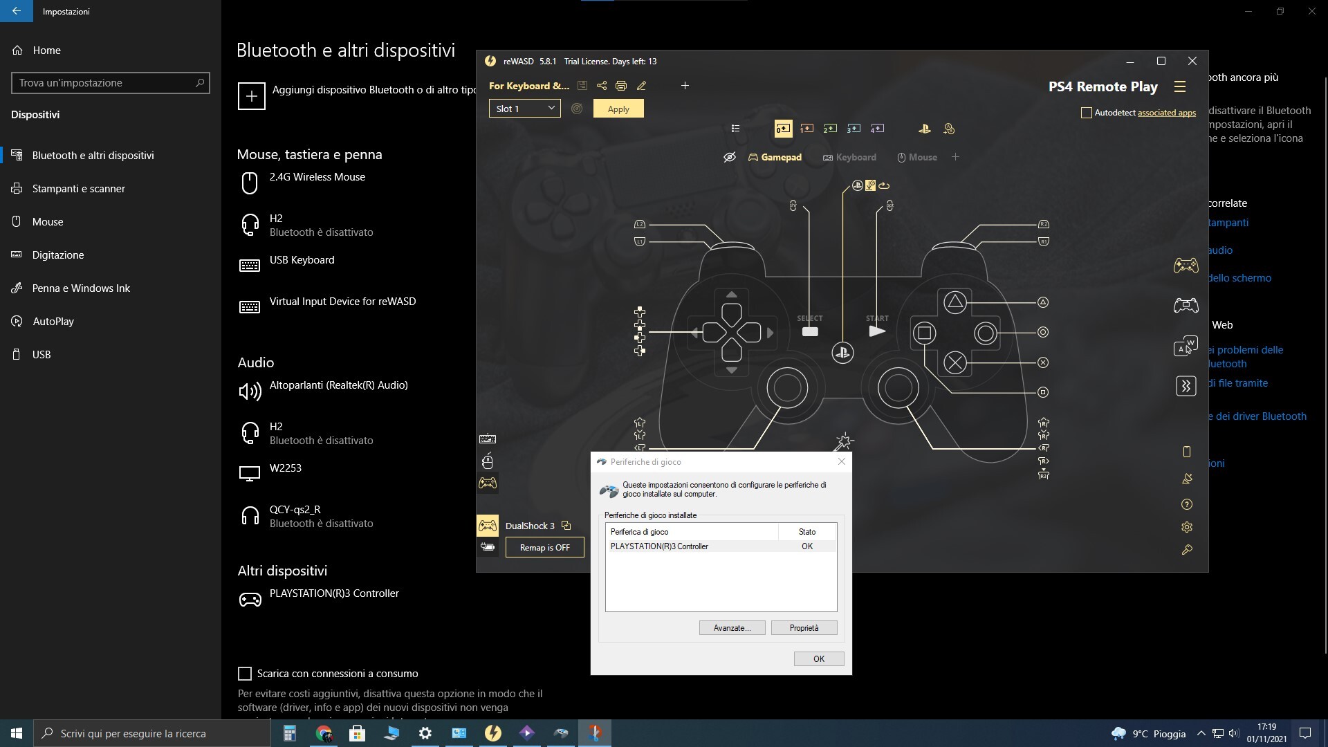

          I uninstalled every mapper application and every third party driver, then uninstalled and reinstalled rewasd, but still I'm unable to make it work 😅
          When remap is off joy.cpl shows a ps3 controller, when it's on no controller shows there, but under devices (settings) virtual dualshock for rewasd appear.

            Please send me the file with system information. It doesn’t include any personal data but shows active processes, installed apps and drivers. We will check if there is something that may prevent DS4 from appearing in the system.

              In the end it was a vigembus driver that was still installed, despite it wasn't displayed inside Device Manager. I had to use Driver Store Explorer to uninstall the driver, then reboot windows, and finally uninstall and install rewasd again. Now everything works as it should.
