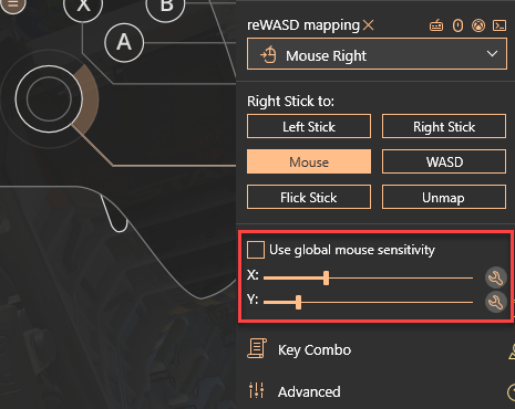

            I can only think about these values being too high (taken from the config you have sent):

            There is a need to find a balance between these values and the ones set up in the game for mouse sensitivity, as they both affect how camera/mouse movement will be perceived by the game. Big values will allow for faster turns but will sacrifice accuracy and add to the "jittery" effect.
            If you are using the same values in reWASD for every game, then you should tweak corresponding values in each game, to get the same result.

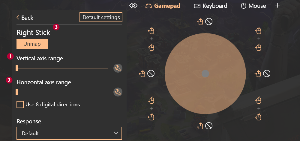

                I have one a few more things to suggest:
                Please minimize Virtual and Horizontal axis range (1, 2), it will make the mouse movement smoother. Also, I still suggest that you unmap (3) the stick in the Shift mode where you use it, because there are no reasons to keep both inputs in your case, when the stick works as a mouse inside the Shift layer only:
                Click image for larger version  Name:	a344248b69.png Views:	0 Size:	223.0 KB ID:	228333
