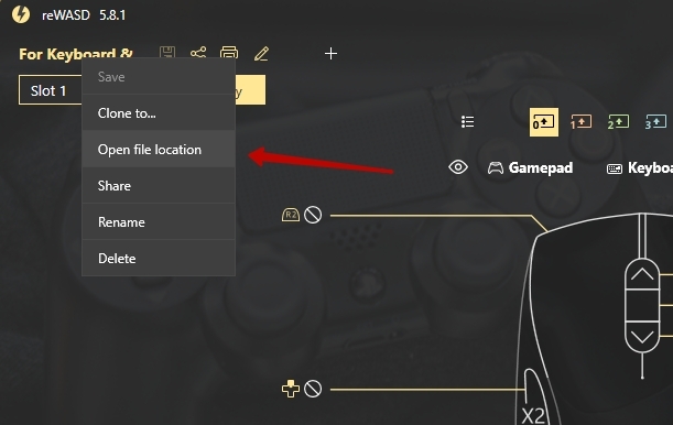

    Please send screenshots of your config, or the config itself.

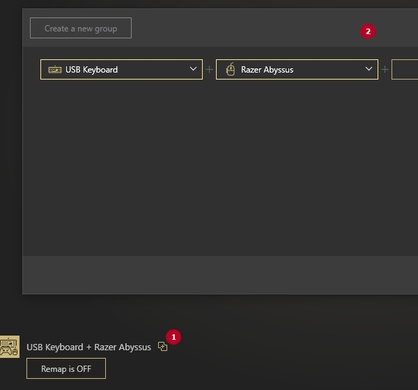

            For this config, it is better to disable the Xbox controller or add it to the group. All the devices should be grouped in order to emulate the input on behalf of the same device.
            Please show me your group, like here:
            Click image for larger version  Name:	cb2245abf0.jpg Views:	0 Size:	35.0 KB ID:	228452​
            We also noticed that you do not have a touchpad click. Better to assign it, as it may also be needed in a game that uses a touchpad.
