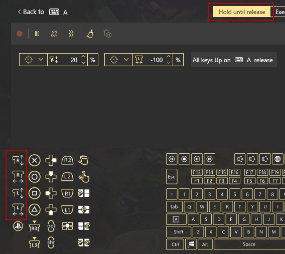

      Could you possibly show how you would do that and if it’s possible to get like 2-3 o’clock and 9-10 o’clock
        Try to set direction with a combo. Create an appropriate combo for the A and D keys, as shown in the screenshot. In this case, the stick will not move strictly to the left/right, but with an inclination of about 9-10/2-3 o’clock.

        Here is done for A. For D change + and -.

          Problem that I'm having with this is when I go from holding W+D/A to solely pressing down D or A it just stops and I have to press D or A again to move.

            Basically, the combo you were advised to create was correct. Only in your case, you need to change absolute deflection to relative deflection. Then you should get the requested result.
