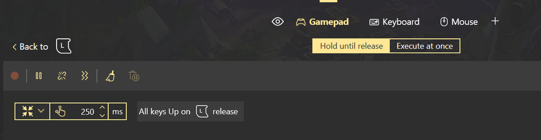

    Hi
    How do i map
    1) left trigger to zoom out (touchpad two finger slide together)
    2) right trigger to zoom in (touchpad two finger slide out)
    This did not work?
    Your setup seems to be correct. Where do you try to check it? Any particular game?
    Please note that 250 ms is a duration of the zooming event. You should try different timings for your case, because for some games may not be able to detect it.
    With Hold until release mode, your Zooming events will repeat while you press and hold the trigger, but the duration of the zoom itself is set by the value you see in the Combo Editor.
