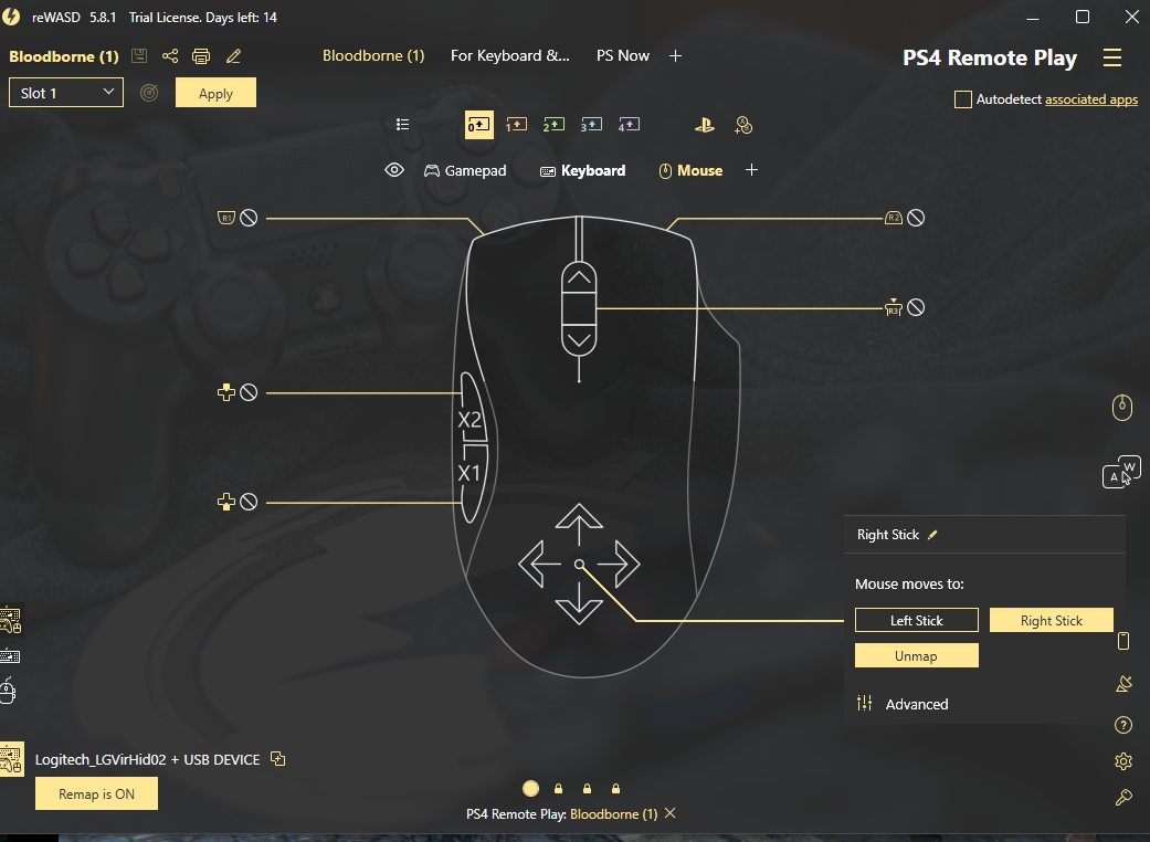

      So, I've started the trial periods for rewasd, combo and advanced mapping.
      I've experimented around a bit with both my own configs as well as downloaded configs for PSNow.
      So far no luck The keys seem to work fine, but I just can't get the mouse input to work.
      After applying changes and activating remap, the mouse cursor isn't captured for some reason.
      I've tried both sticks in mapped and unmapped mode. Still won't work.
      I've also tried to unmap all sticks from what I assume is the virtual controller.
      Hardware: G502 (mouse) and a Redragon mechanical keyboard.

        It may be a chance that the device initialization is not completed correctly. Please follow these steps:
        2. Use Detection mode to find the correct Keyboard and Mouse. If you press the mouse button but see keyboard in reWASD, then you will need to re-initialize it (from the contextual menu of an active device)
        3. After you are sure about all the devices, please group Mouse and Keyboard and try to Apply your config and test it in a game
        As I can see, you have chosen Logitech Virtual Device. This one should not be used. You need to find a "real" mouse (I think it should be named as G502).
