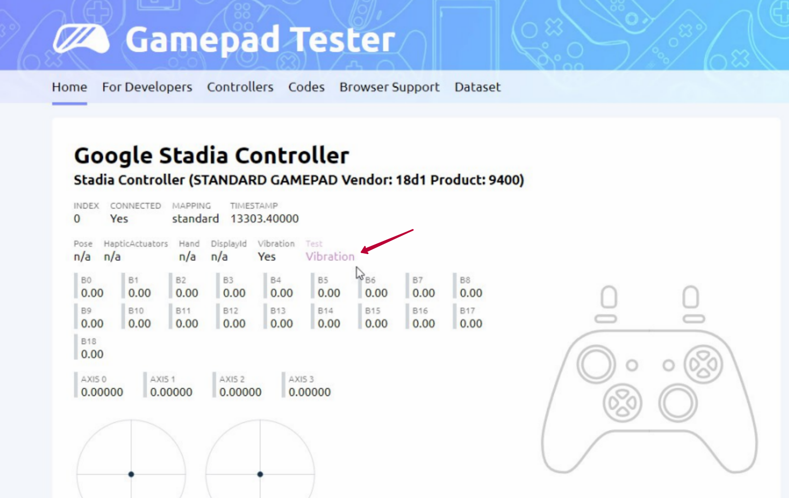

        Pretty strange, because Google Stadia should be detected in this tester. Here is how it looks from my side, and here is the Vibration button:

        Please check a few more things:
        • You are using the wired connection, right? This is the one used for gaming.
        • Check gamepad-tester from other browser. The screenshot above is made from Chrome.
        • Once you open the site, please press any button on your gamepad — it doesn't recognize the devices until you press something
        • Type joy.cpl in Windows search to open the native system gamepad tester. Do you see your controller there?
        You do not need to kill our processes completely, but ensure that Remap is turned OFF — then we are sure that reWASD doesn't influence your controller anyhow and doesn't hide it from the system.

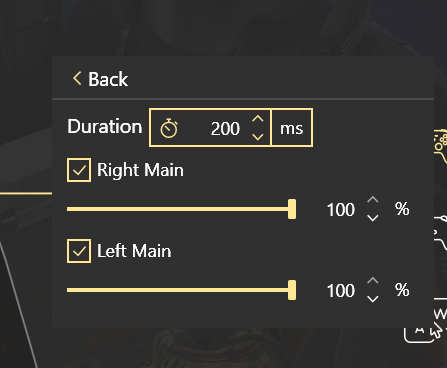

            In reWASD, choose any button, go to Rumble section and check Right and Left motors, set Duration and increase sliders to 100%. Then Apply this config, and try to press the button. Do you get the vibration in this case?

              Could you please try one more thing for me?

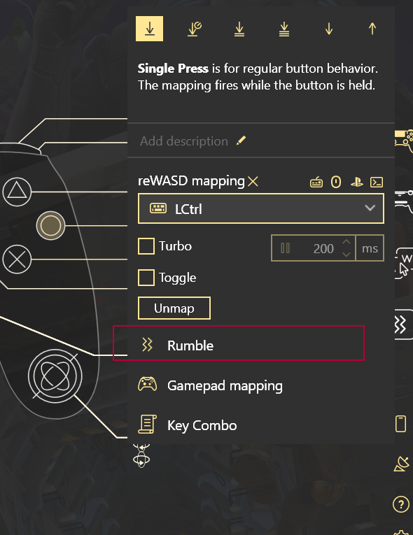

              by rumble section do you mean this?

                I am about this one:

                Please check it first. Rumble section is a part of the basic license. Some functions are locked for it, but you can enable the trial mode for each advanced feature, so it should not be a problem.

                  yes pressing that button rumbles
                    This proves, that reWASD is able to trigger vibration for your controller, and thus should pass-through any vibrations generated by games for virtual controller you are using.
