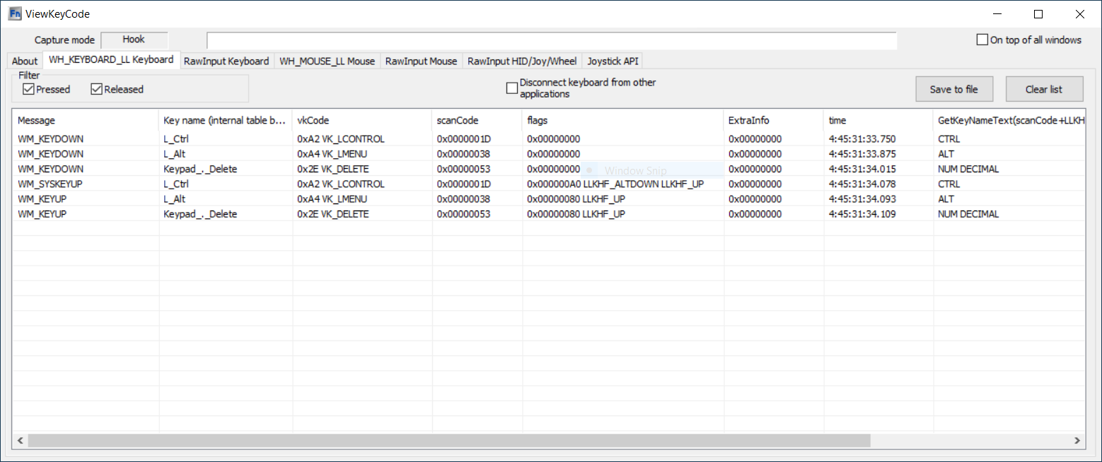

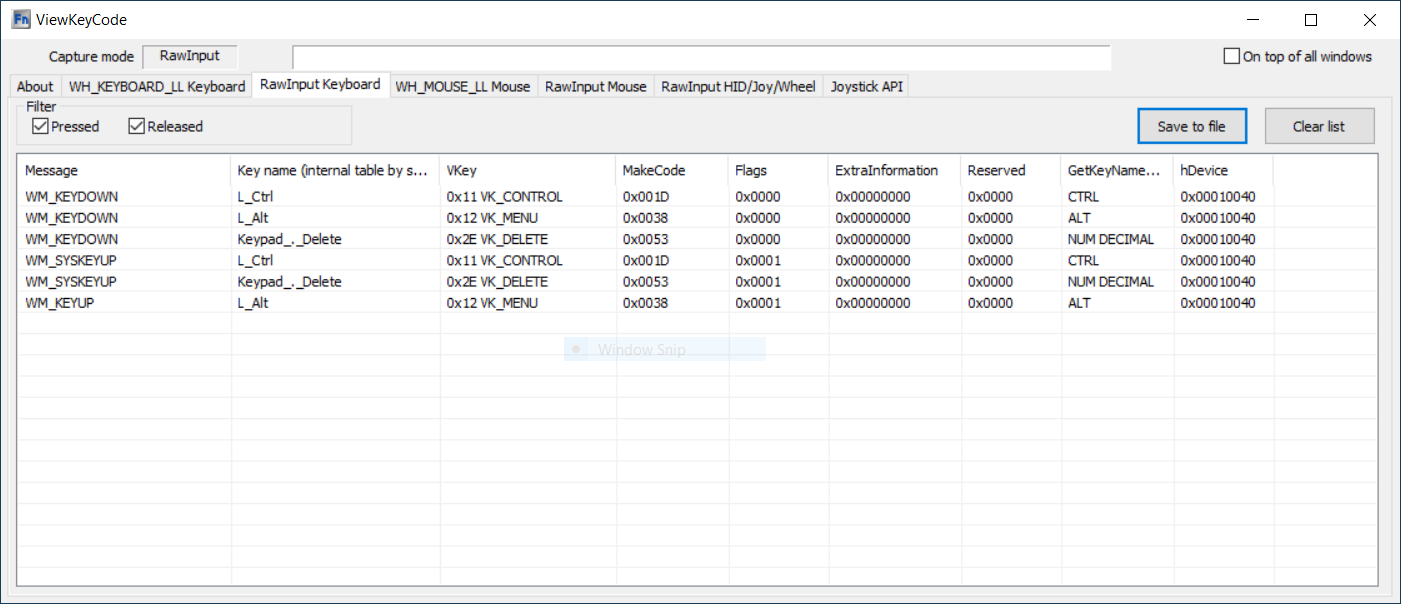

                  Quick follow-up to me previous post: would be great if you could collect the log of the keyboard input for us. Here are the steps:
                  1. Please download this tool: http://files.disc-soft.com/filer/shared/1640258846/707/
                  2. Open it and switch to RawInput Keyboard tab (1) and check Released option (2):
                  3. Then press Ctrl, Alt, Delete — all together or one by one, it should detect both things, just like I have it on the screenshot above
                  4. Then repeat steps 2 and 3 for WH_KEYBOARD_LL_Keyboard tab (it's on the left)
                  Please send me the screenshots you get for the investigation.

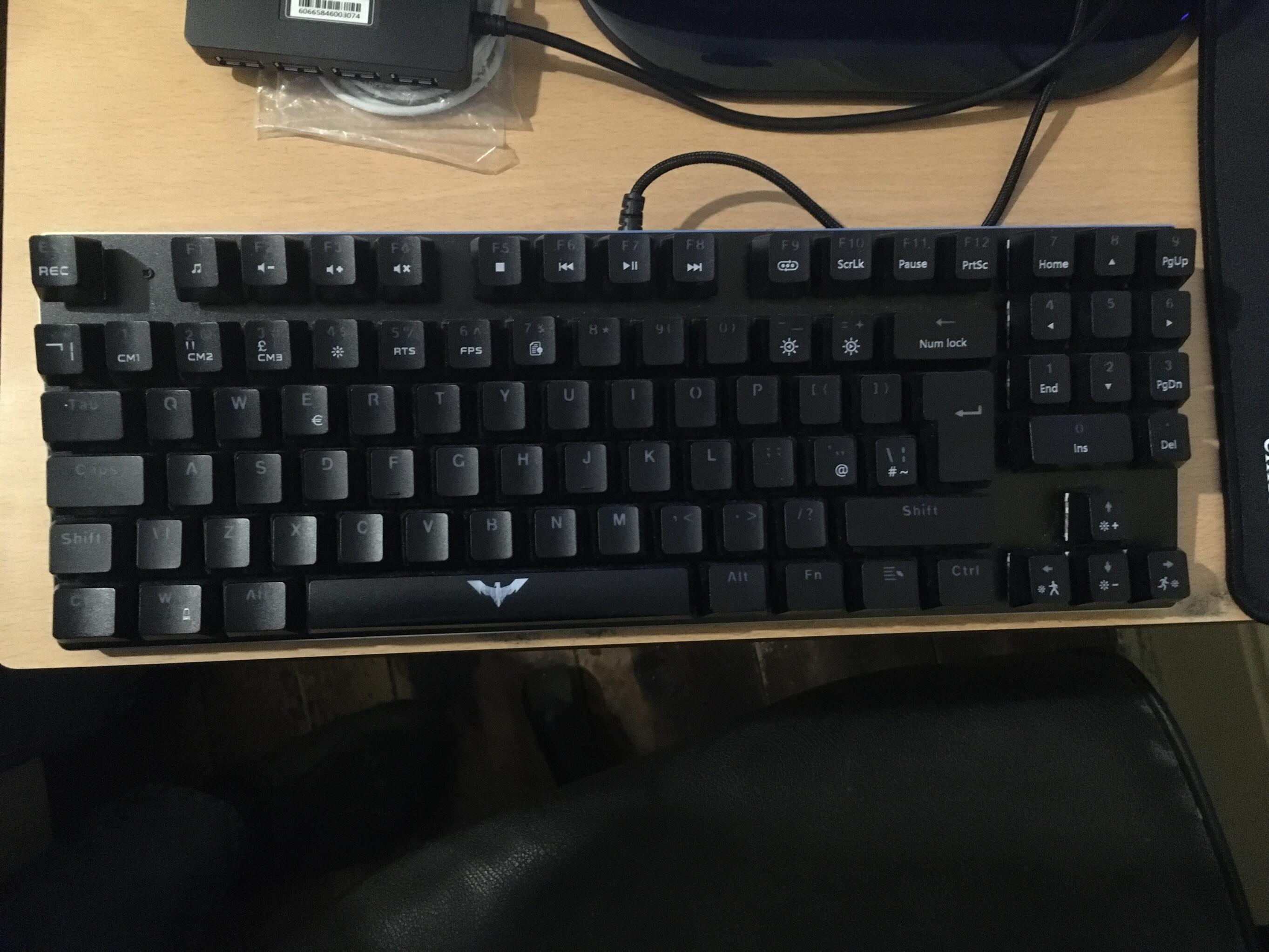

                    I noticed it shows "Keypad_._Delete" not sure it this makes a difference but my delete key is on the numpad, i have no other delete key, perhaps this could be the problem?
                      That is exactly the reason: reWASD requires [Any CTRL]+[Any ALT]+[Delete] keys for "emergency shutdown". [Numpad/Keypad Delete] key is ignored in that regard.
                      Can't say for sure without a photo of the keyboard, but if it has a [Fn] key, then there might be a normal key that can work as [Delete] with it. If there is - it should work.
                      I suppose we have something to think about now. Thanks for letting us know.

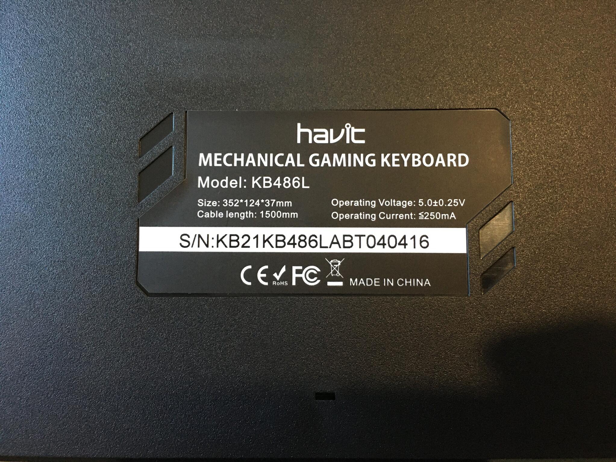

                        Yes can confirm it is, forgot that i had a spare wireless keyboard and tested on that and emergency off works. My main keyboard is a HAVIT KB486L, tried with Fn on and off but no luck. Hope you can include a fix in a future update.

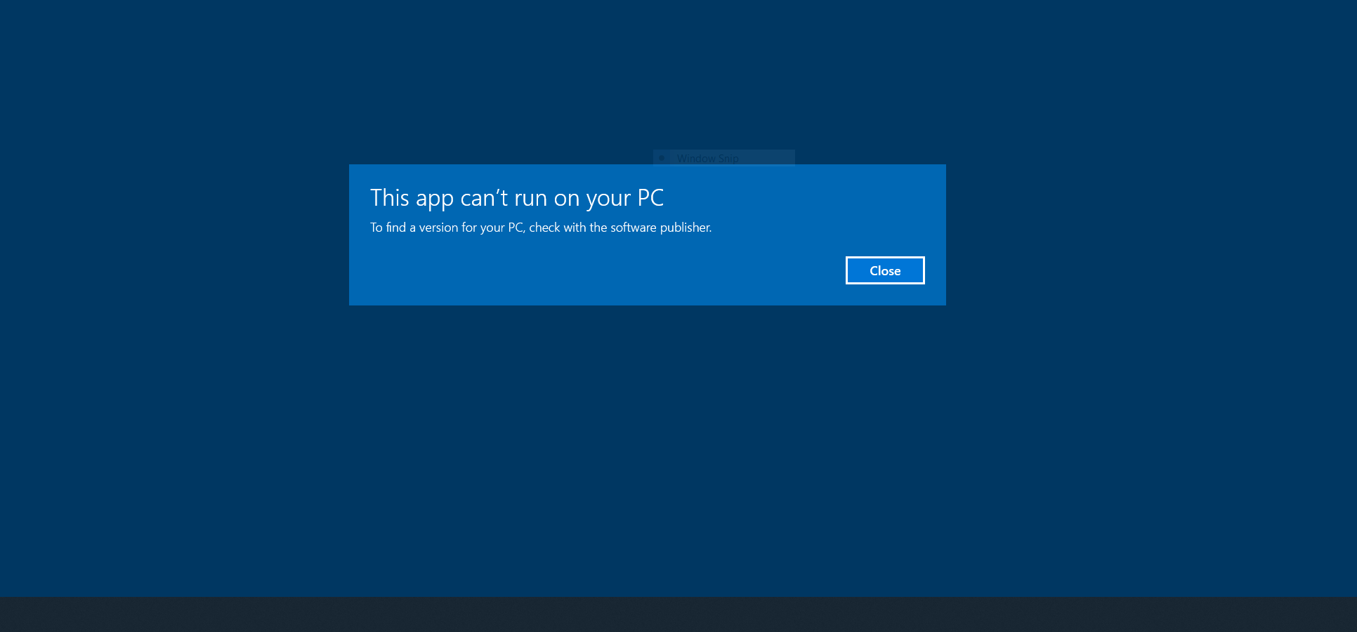

                          Hello! I have just sent the link to the special build for you which should fix the issue — in this one, Delete key from Keypad is also acceptable for our emergency hotkey. Would be grateful if you try
                            I downloaded the file you sent but again i'm getting "This app can't run on your PC", tried a few different things but it won't open.
