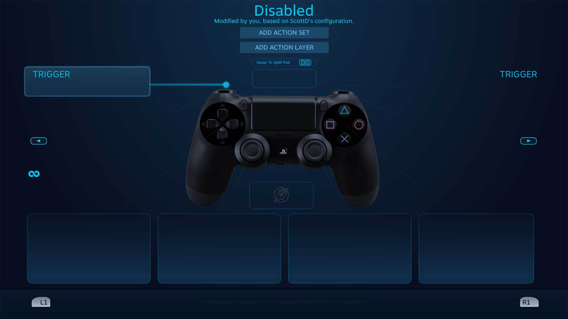

                Guide Button Chord and Desktop configuration in Steam ... this is how it should look? (havent touch big picture mode yet)
                      [Desktop] config should be empty by default. The [Guide Button Chord] config is always applied to every controller that Steam has support enabled for. The way it is configured by default matches the description of your issue. Though there is a thing - mappings of that config work only together with [Guide] button, what makes me assume, that your [Guide] button is probably stuck, damaged or too sensitive, so you end up accidentally pressing it along with bumper buttons. Removing all mappings from this config should work as a solution, though those "Chords" (shortcuts) would become unavailable as a result.
