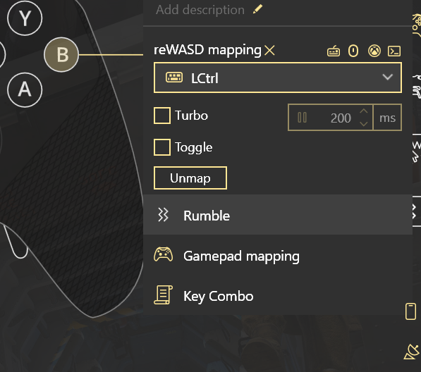

                            Am I right that you are testing the in-game vibration? Could you please check the following:
                            1. Go to Rumble menu for any controller button
                            2. Check all the motors and set any duration
                            3. Apply a config and check whether it vibrates when LED is on

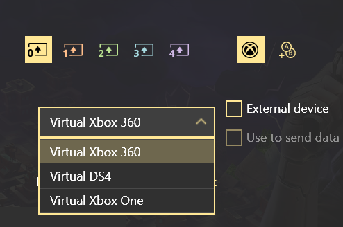

                            Also, please re-check which virtual controllers you use for your configs. DS4 and Xbox 360 only?

                              Checked adding rumble in rewasd whilst rainbow led is on and it works perfectly. My virtual controller drop downs are exactly as pictured in your screenshot.
