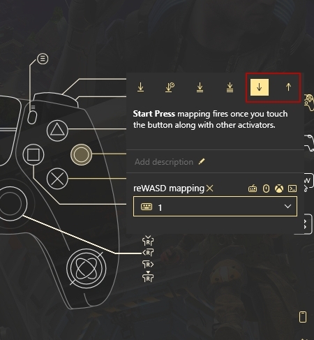

    Can reWASD change an ingame setting to what you want ?
    example PUGB has inventory on toggle can reWASD change that to hold so once you release a button then that said action go back to normal ?

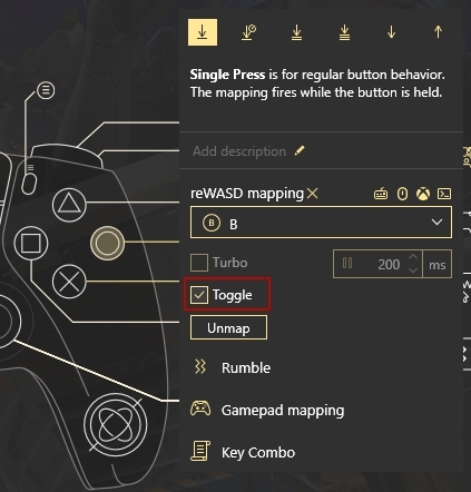

    Can reWASD change a ingame action lets say a game only has hold crouch can reWASD change that to toggle?

    To open and close the inventory using the hold, use Start Press and Release Press. Assign a button that is responsible for this action for both of these modes, and leave Single press without mapping.
    Click image for larger version  Name:	5mdVyMGCaWEjlA.jpg Views:	0 Size:	97.6 KB ID:	229243
    To activate the squat by holding, use the Toggle checkbox for the corresponding button (this requires the Rapid Fire feature).
    Click image for larger version  Name:	82Q1b5WIVoEjy2.jpg Views:	0 Size:	78.0 KB ID:	229244
