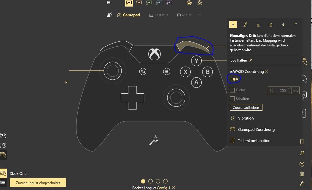

    Hello, i try to configure a combo for the xbox one controller.
    In my configuration the RB Button should activate the F and the K key button on the keyboard. This works fine at the moment.

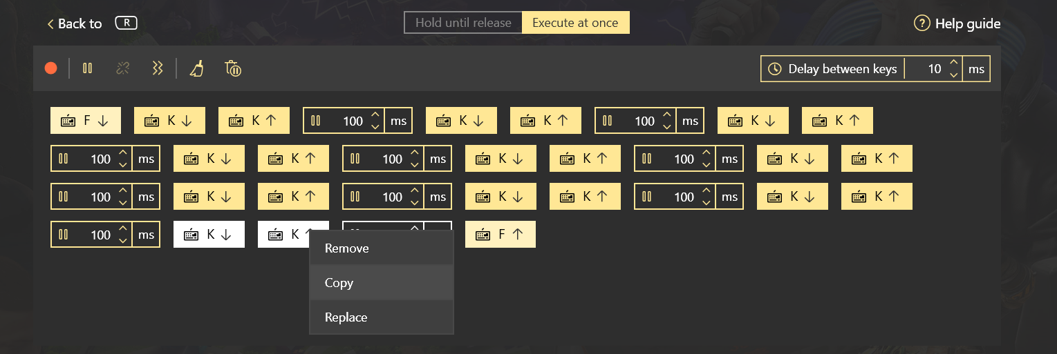

    First, you need to set a manual combo with the pressed F and several K (which are separated by a pause — 100 ms if you need it to be pressed 10 times per second). The easiest way to do so is to add K (pressed and released) + Pause and then copy this thing and paste it as many times as it may be required. You will need to add the max quantity of K keys — so the initial combo length should be equal to the longest time you press and hold RB. Here is how my 1-second combo looks like:

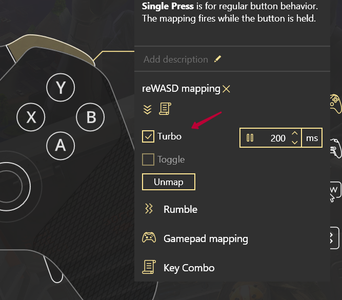

    Now, we need to stop this combo once you release RB, and to do so, we need to use Turbo:
