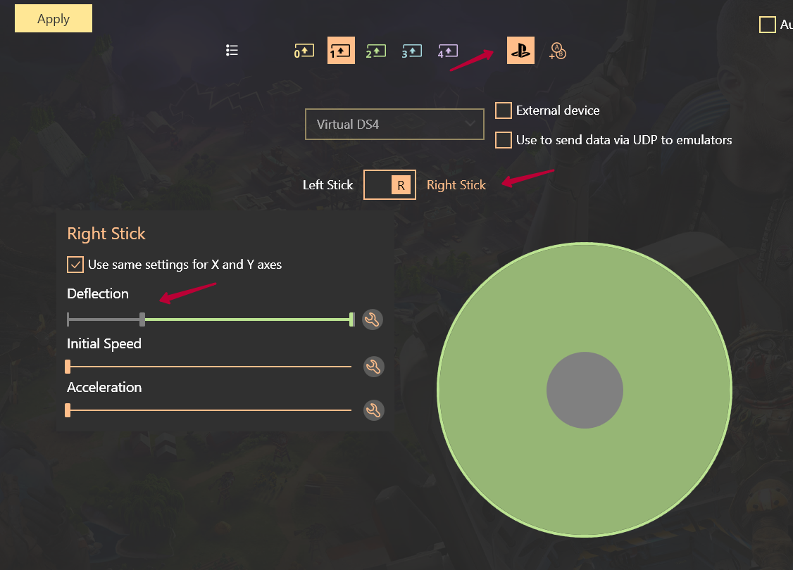

    I have tuned your config a bit — it seems that you had a few explicit mappings on your mouse in Shift mode (the one that is activated when you press and hold Right Mouse button). Also, I have increased the Initial Deflection of the stick in Shift mode, because most games have different stick sensitivity for the normal and aiming mode. Please try my config and let me know how it goes.
    Also, I am unsure why you need to emulate a combo that consists of a trigger, a zoom and a stick click on the right mouse button. Maybe we should remove it too? It may also interfere.
    The config with my changes is attached below.

          Eh probado el "edit" lo que sucede es que al aumentar la deflexión inicial se pierde un un poco la puntería, ya que a mínimos movimientos del mouse se mueve para todos lados.
            Got it, then decrease it here:

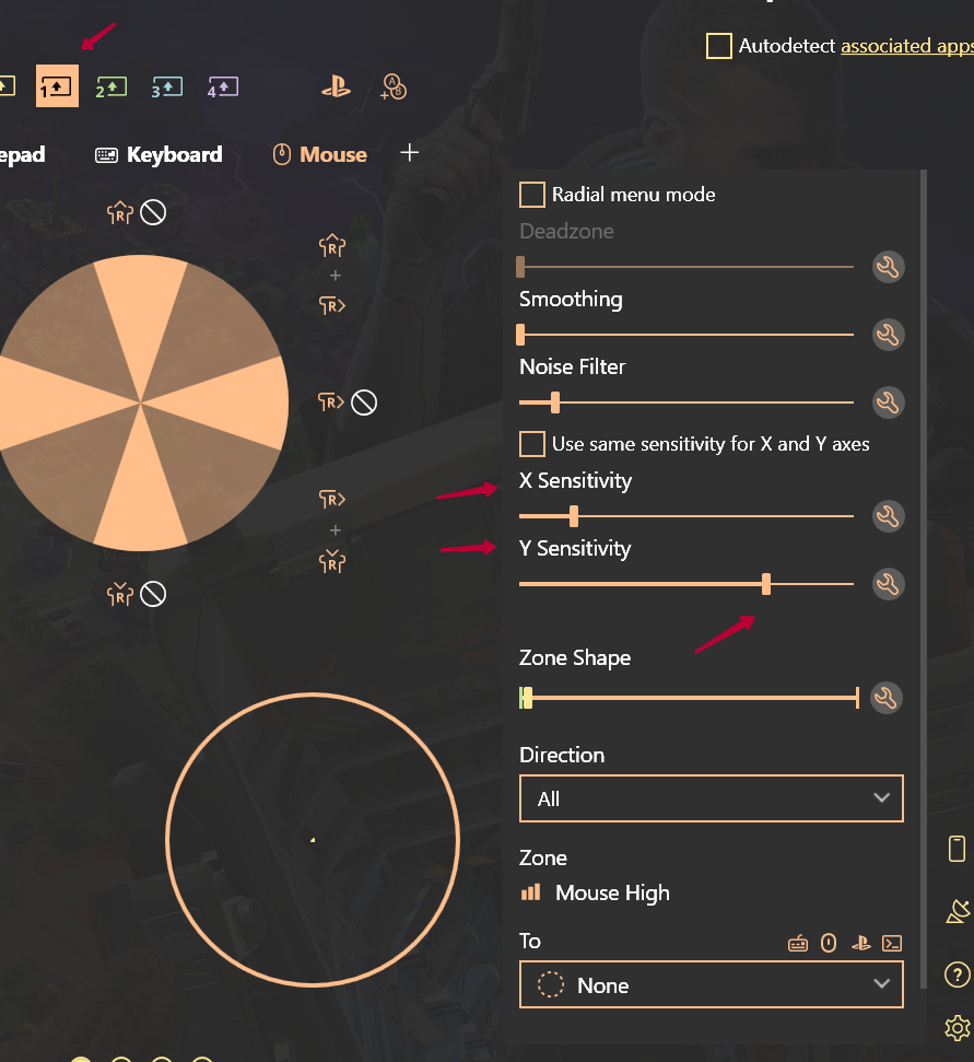

              yo había añadido para corregir el problema planteado una "forma de la zona", para corregir el movimiento.. pero no me termina de convencer.
                Si eh probado de todo. Pero me falta ese detalle nomas, lo demas todo ok.
                  Zone mappings won't help with this case, but I have one more thing to try:
                  Please try to increase Y Sensitivity for the Shift 1. You may also need to increase the X Sensitivity a bit, but if your issue is connected to Y axis mostly, let's start from this one.
                    he probado eso también... Es complicado el asunto jaja, necesitaría esa movilidad extra del mouse sin perder precisión. obviamente en todas las direcciones del mouse.
                      Pretty many games reduce the sensitivity of the stick while you aim. You should check if the game allows you to increase the sensitivity for the stick in the game itself — then you won't need to increase this parameter (or the initial deflection) in reWASD, and your movement will be still precise.
                      Otherwise, I would suggest that you tune the Response curve too (it is on the left, on the same tab) — it could give you more freedom while adjusting.
