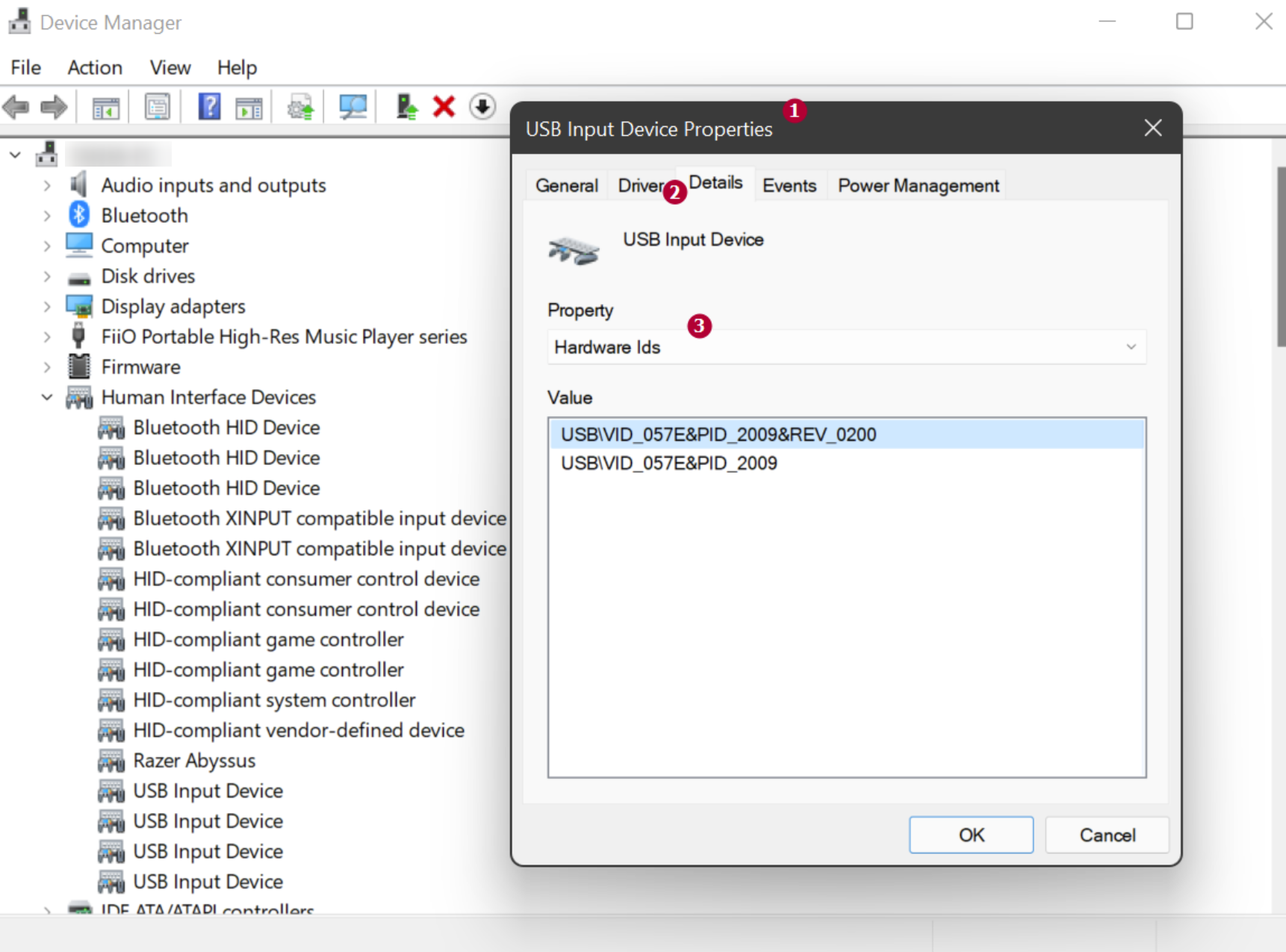

    • Could you please check which VID:PID it has? You can see info in Device Manager. Locate your controller, go to its Properties (1), switch to Details tab (2) and check Hardware Ids (3):

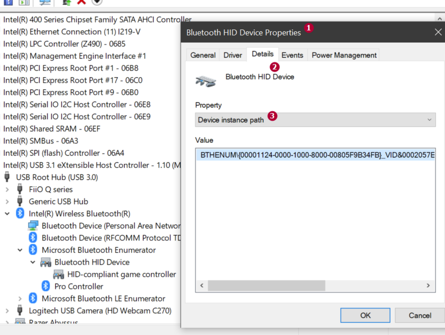

            1. You need to locate your controller in Device Manager (or on Devices and Printers in Control Panel) for both connections (wired and wireless) separately. For USB connection, choose USB Input Device. For Bluetooth settings, go to the ones that are related to your adapter.
            2. Once you find it, you need to go to the following option: Properties (1) -> Details (2) -> Device instance path (3) and you need to copy the value you got here (screenshot):

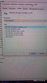

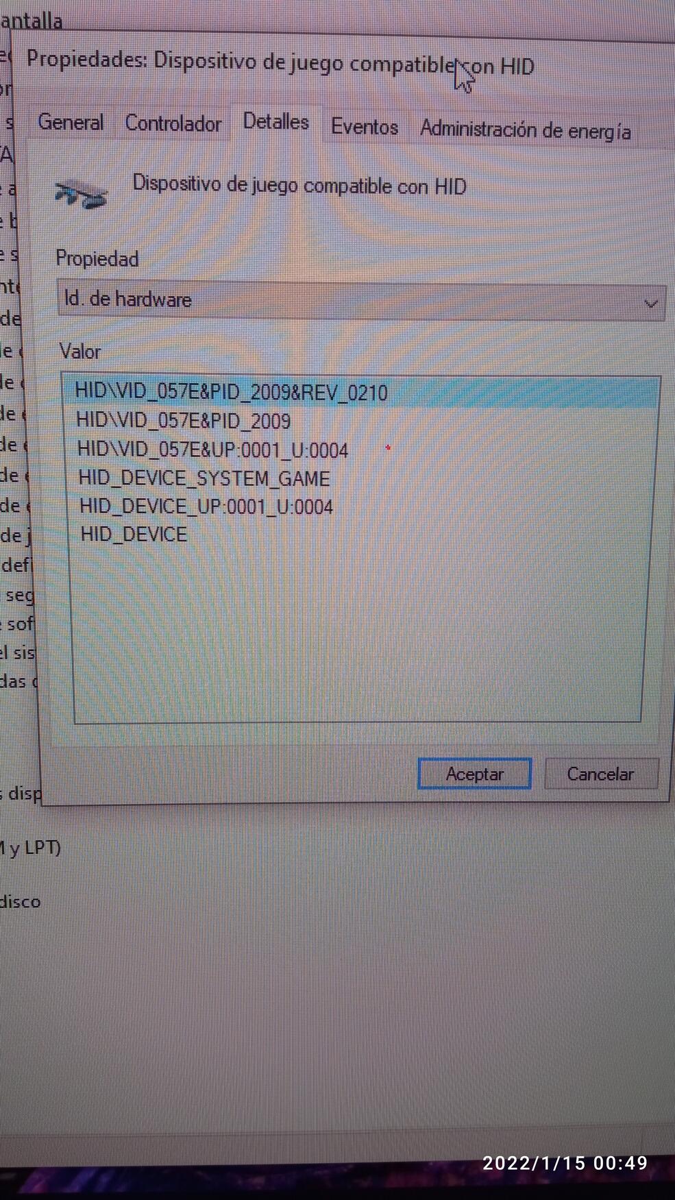

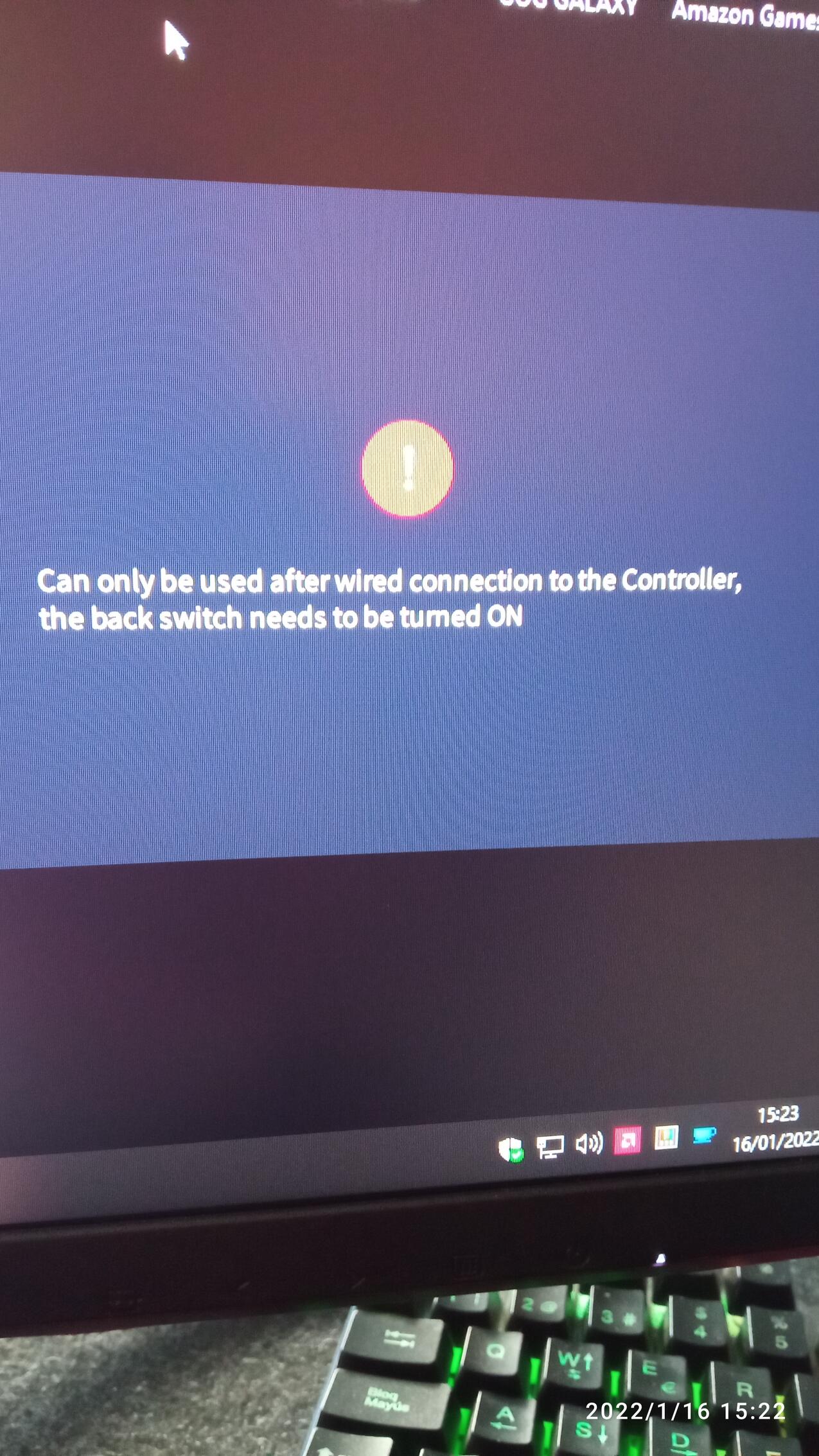

                The foto 😜 I play last night with this
                  Got it, thank you. It is the same as an original gamepad.
                  The steps should help.

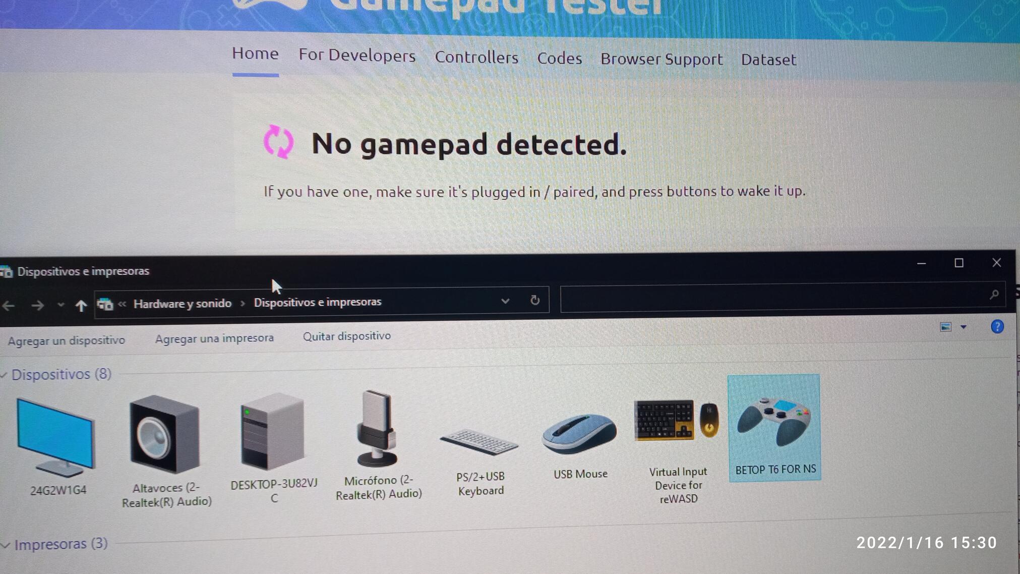

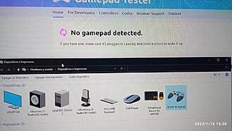

                    windows reconoce el dispositivo pero no funciona por ejemplo en la web de prueba ni en los juegos 🤷
                      Have you restarted your PC after changing the keys in Registry editor? The restart is required here.
                        Yes and dont work without REWASD
