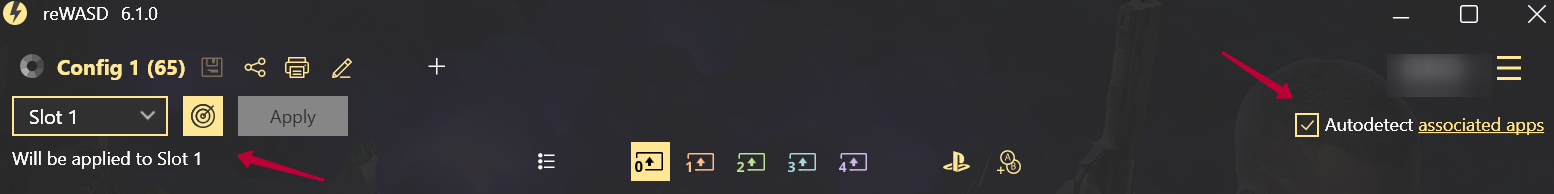

      Please ensure that all the associations between the configs and processes are adjusted properly.
      With 6.0+ release, we were forced to remove the previous adjustments, and so Autodetect should be re-configured once again. Once your gaming device is chosen at the bottom left, open the config you want to be applied automatically and check if both these options are checked:
      Click image for larger version  Name:	a0ea2afef5.png Views:	0 Size:	106.7 KB ID:	229567
      Also, please ensure that you are using the latest version — 6.0.1 that could be downloaded from https://rewasd.com/
