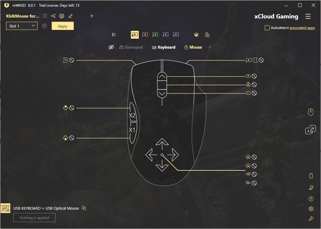

    Hello everyone, I imported the config, but for some reason the camera in the game does not move, I move the mouse but nothing happens.
    Hey!
    Please check the License ( at the bottom right). Go to Advanced mapping feature to see if it is active now (has Trial days left shown in a title).
    Also, send screenshot of your config.
      The trial period is valid for another 13 days
        Then it may be a chance that the device initialization is not completed correctly. Please follow these steps:
        2. Use Detection mode to find the correct Keyboard and Mouse. If you press the mouse button but see keyboard in reWASD, then you will need to re-initialize it (from the contextual menu of an active device).
        3. After you are sure about all the devices, please group Mouse and Keyboard and try to Apply your config and test it in joy.cpl or in a game
