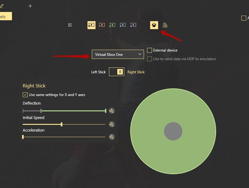

            Hey! Please check other virtual gamepad types here. Change the type, apply a config, restart the game and check:
