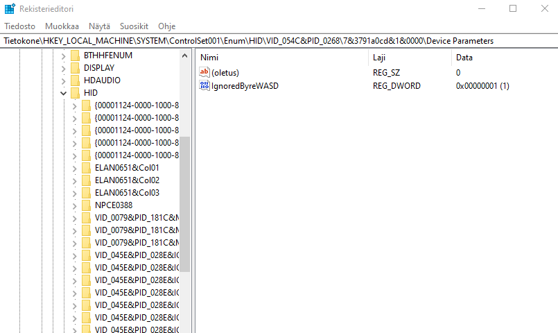

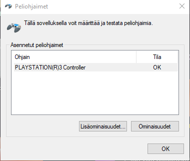

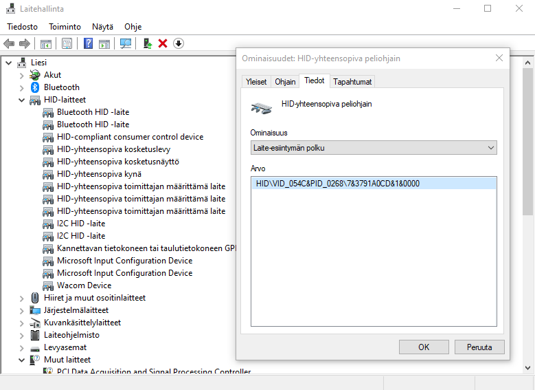

      Thanks for quick answer and help. I did how you said and issue is still the same. I'll still make sure I did the right thing:
Name:	Device Manager.png
ID:	230021Click image for larger version
ID:	230022Click image for larger version
      And after controller unplug and replug and pc restart it's still the same. ​

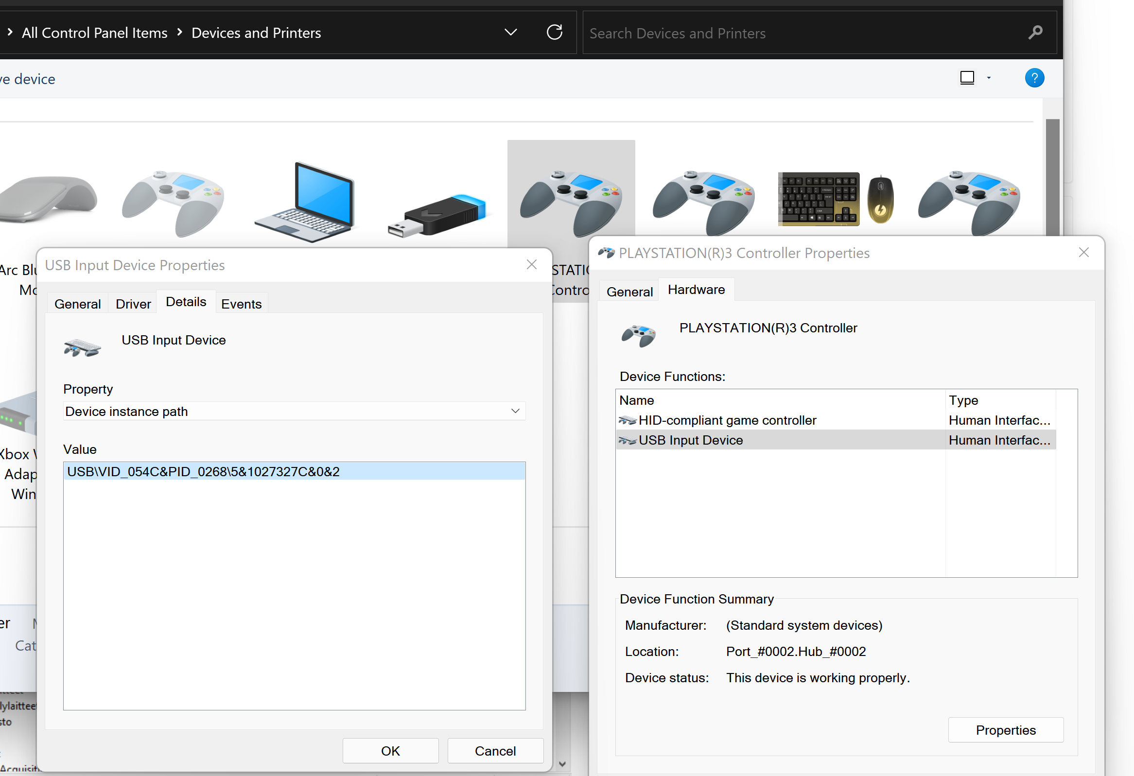

        It seems to be the wrong device, as the one we need is USB Input Device.
        You could try to locate it via Control Panel -> Devices and Printers, it may be easier in this case. Here is how the original DualShock 3 is detected on my PC:
          You are genius! That worked, thank you very much. I will buy license today
